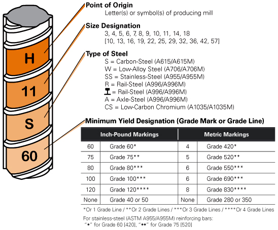

Having worked with both Re-Bar and Steel i've convinced myself re-bar is more like wrought iron than steel according to Wikipedia etc. and , i'm presently too far way from my grinder to do a spark test . Which do the X-perts say ?

We have a rebar factory I can hear on a quiet night. T posts, angle iron too. Made from European train rail. So it's grade 80 plus. It will snap when you try to bend it. Yes I have a rebar bender. I buy my bar at another place if I need to bend some. I've made good things with the high test bar.

Low end rebar is pretty much junk/mild steel rolled with not much regard for quality....
BUT....
Good quality rebar will have information about its source and composition.

Several different grades of rebar. Some weldable some are not. Some are bendable, some are not. Check the markings as shown above & do some research if the project is critical.

well yes Re-bar is generally more Iron then Steel but like other said it depends ... Id like to point out a more Iron oriented rebar doesn't make it poor in quality or junk rebar, it only has different property like elasticity and malleability so if you want material that will be shock absorbent then need Iron but if you need strength then you need steel and higher the strength the more brittle it become under flexion so Iron rebar are not junk they are just used in different application.
