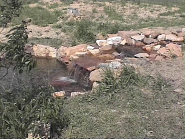

Hope this will be of interest to a few. We have a 3/4 A pond that would drop 3-4 feet each summer drought. Had a well drilled and can get approx. 30 GPM. Ran a 1 1/4" pvc pipe to spot approx 40 feet up hill from pond edge. Started gathering rocks (Harv wouldn't send me his) and put down the heavy vinyl and began to construct "Luny Falls".
Found out my "creek" bed is not wide/deep enough to let the full flow run with rocks placed in the bottom, but not a big problem since 30GPM is way too much, have a valve to adjust flow. When the top of pond overflow pipe starts showing just open a little and in a couple of days... back full. I'll be happy to provide more info to those interested. Let's see if I can attach a picture.
Tried earlier and don't think I can attach two at a time so I'll follow with a second with next post.
Happy New Year ! Norris
JJT, we put some Grass Carp in when we started and two are still living approx. 10 yo. and over 30" long.
Named them G & H...... Graff & Hindenberg. Then last year purchased 5 more... named them S,N,R,T & L
Haven't bought any vowels yet.

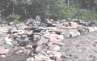

Here's the bottom where it gets to the pond, bordered a dug out section with rocks to give babies sanctuarary,
since my friend Gene help gather many of the rocks this is our "Gene Pool"
