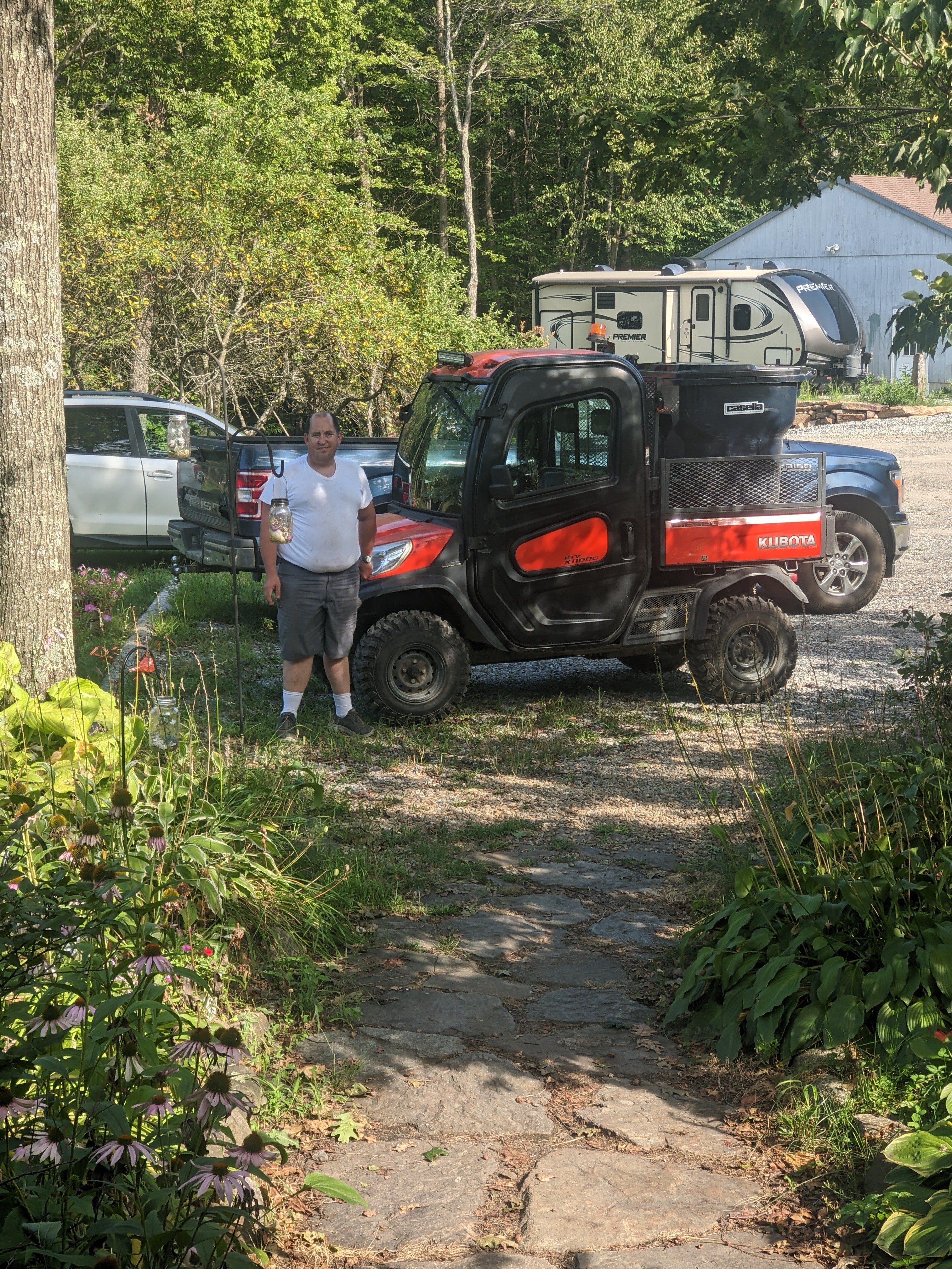

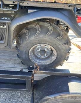

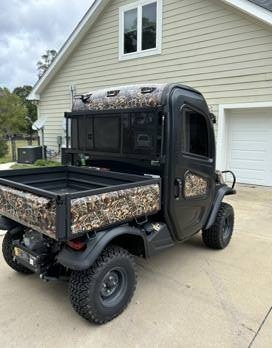

Will 27X11.00R12 75J 10 Ply tires fit the stock rins of an 1100C?
On our RTV 900, we have GBC Kanati Mongrel 26 x10 x12 size tires and they fit with no issues.
Using the 27" tire would provide a bit more road speed and load capacity with the 1100C, but I am concerned that the tire will not fit correctly on an 8" wide rim. The 11" wide tire calls for a 9" wide rim
   / Re: Kubota1100C. What tire size fitment on stock 12 x 8 rim? #2
That should work;did exactly that on a Yamaha sidexside.Went from 25"to 27" on the stock factory rims.
I don't think you are going to gain a lot of extra speed,maybe some carry capacity.
