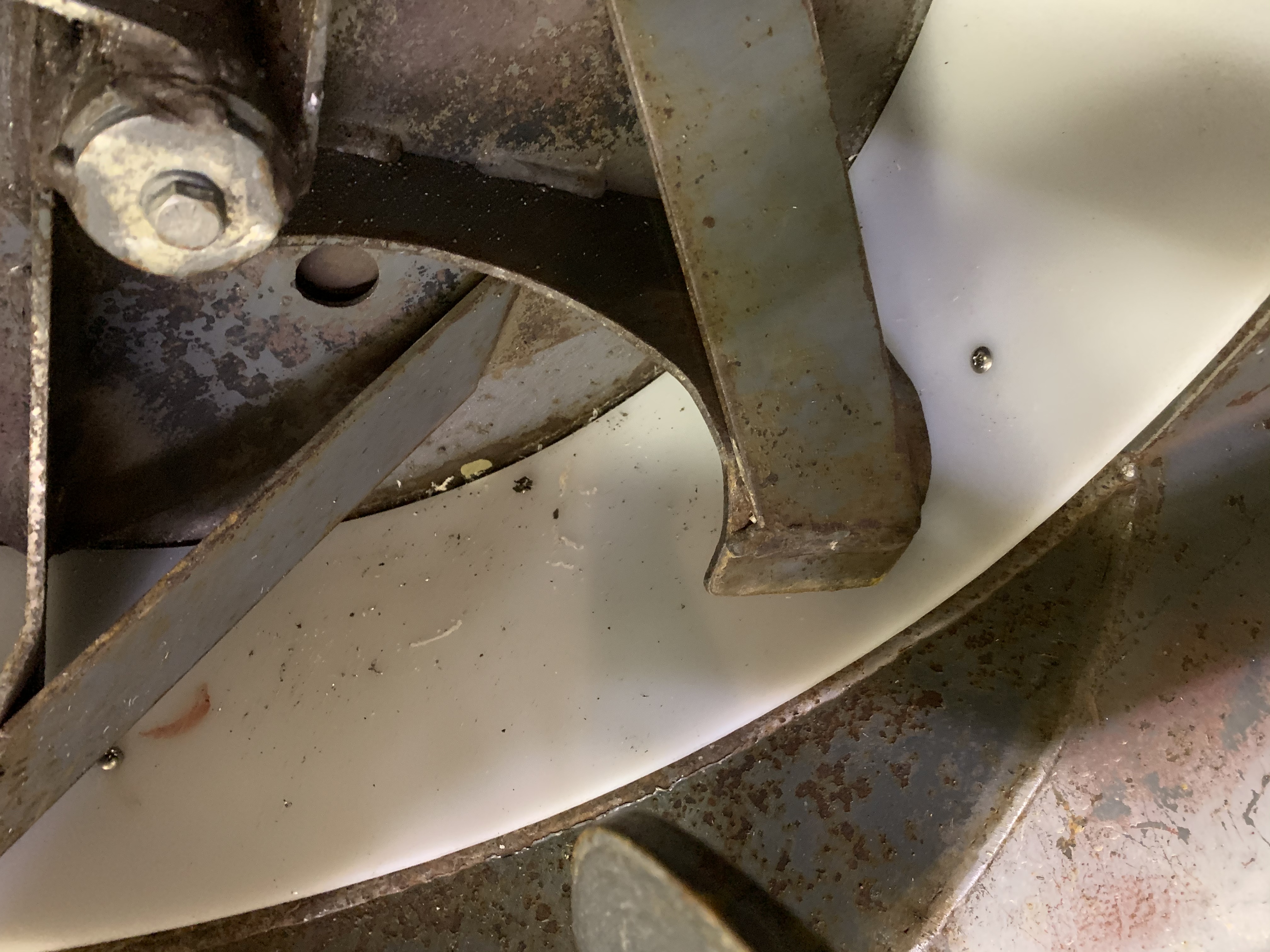

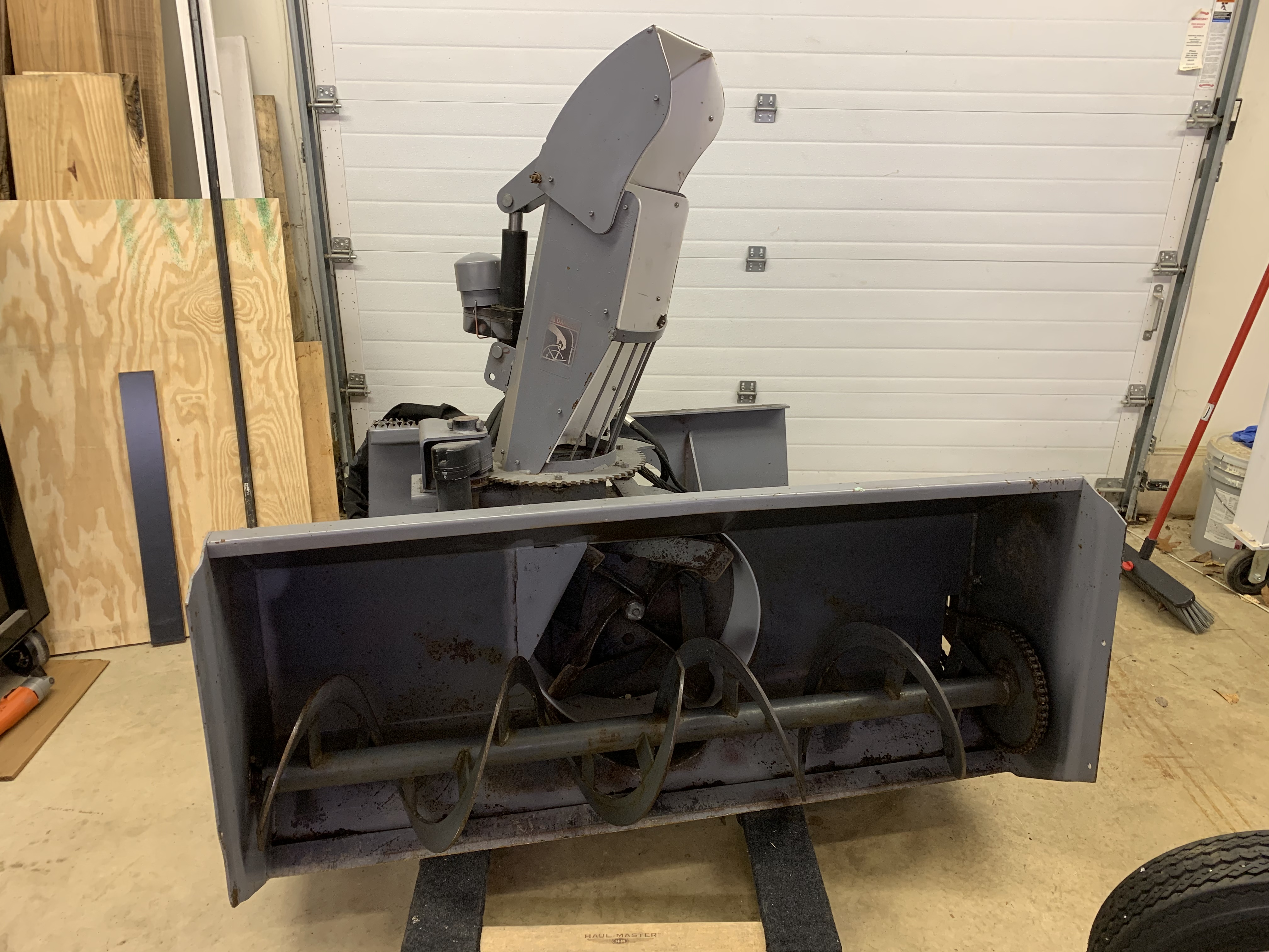

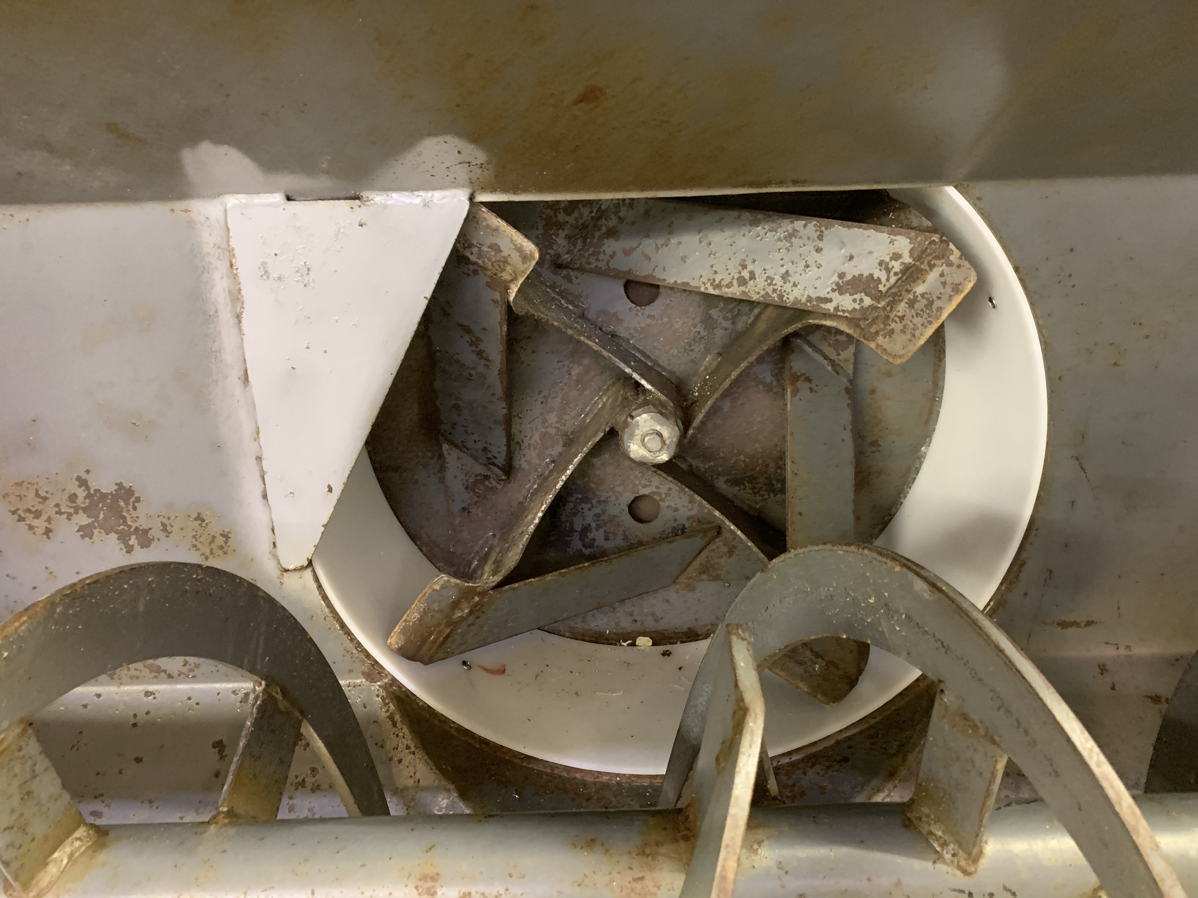

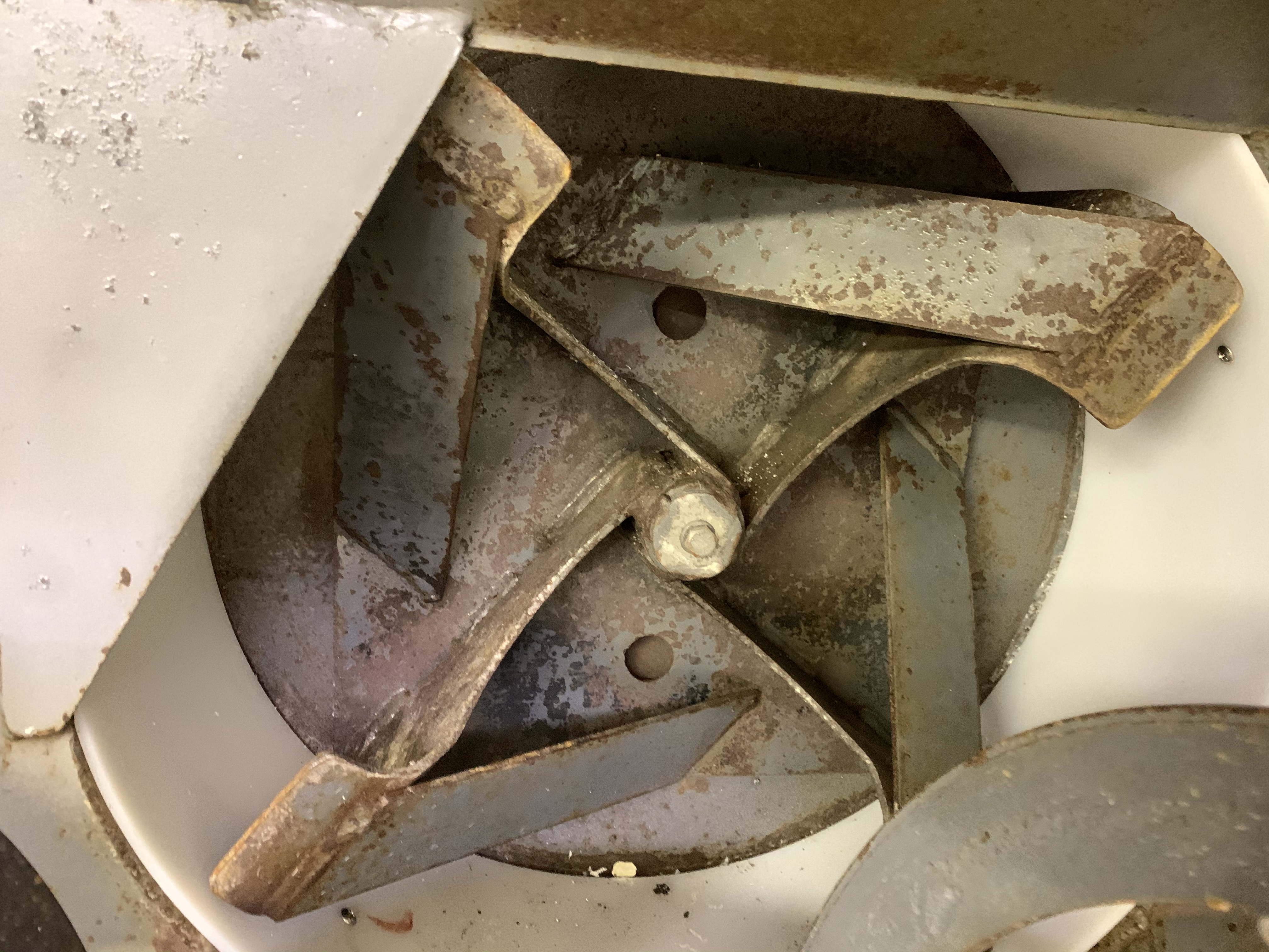

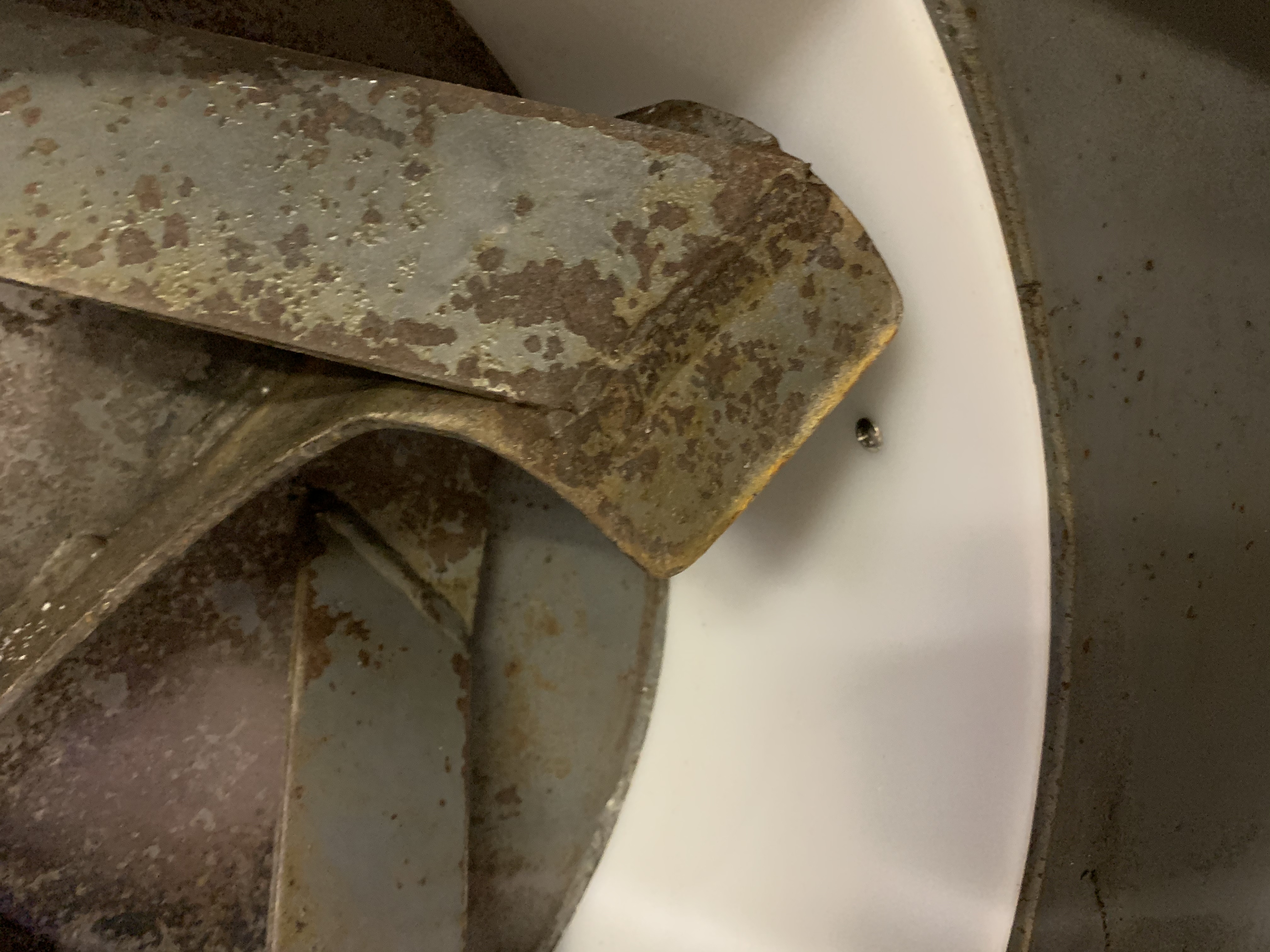

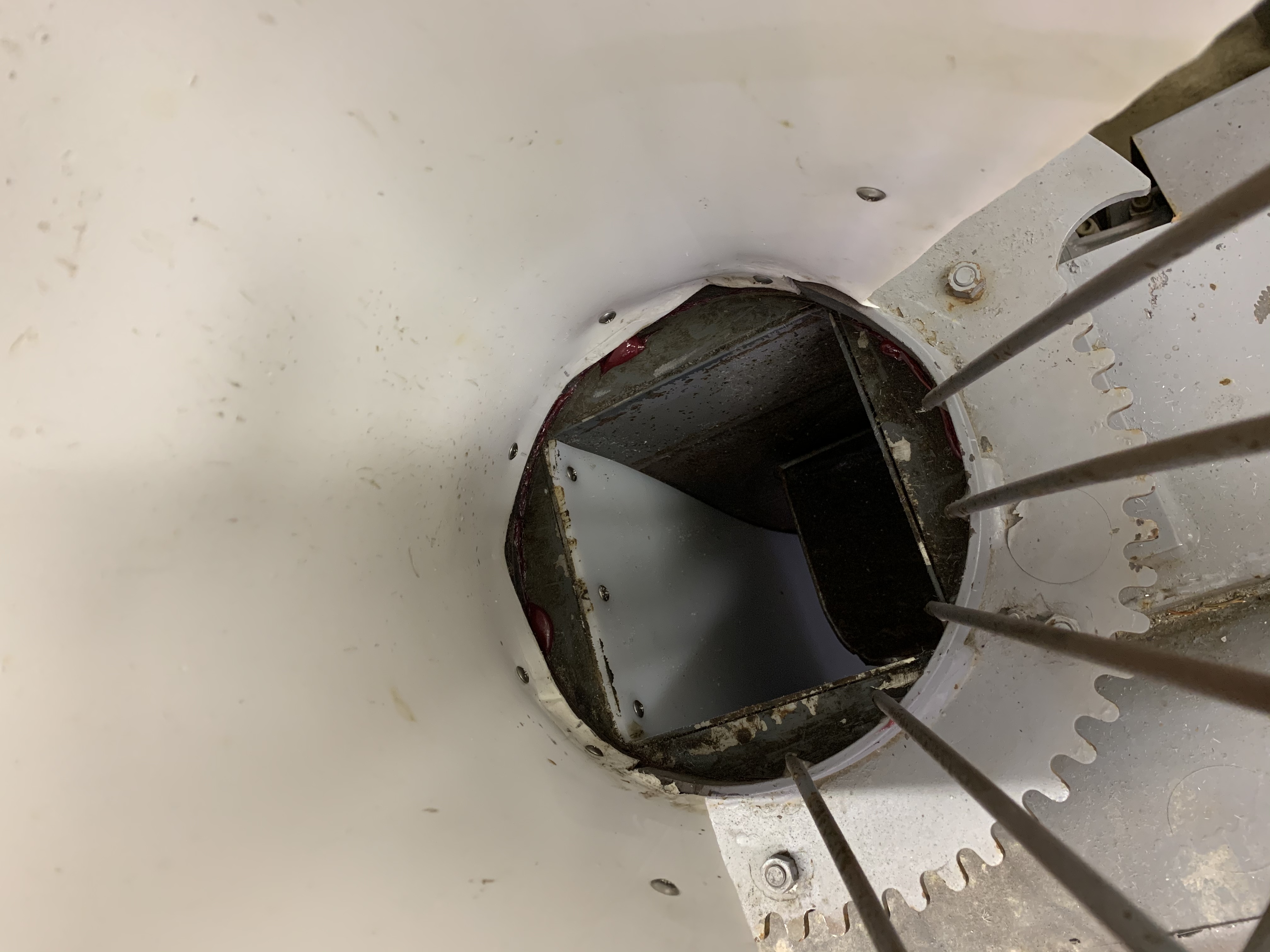

Several years ago I lined the impeller and shute with slippery plastic, High molecular weight polypropylene. At the time , I bought a 4ft piece and had to heat weld two pieces to get a piece long enough for the impeller liner. It lasted 3years and recently broke and jammed. This time I bought a 4x8 and replaced with a continuous piece. I added screws thru the impeller side walls.
In 3years , I had only one jam up, when the snow was slush.
My blower had excess space , like 3/8? between the impeller and side walls. This plastic took up some of that space.

Several years ago I lined the impeller and shute with slippery plastic, High molecular weight polypropylene [(Ultra?)HMW PE]. . . . It lasted 3years and recently broke and jammed. This time I bought a 4x8 and replaced with a continuous piece. I added screws thru the impeller side walls.
When bumperm described his installation of UHMW PE in a post starting on 10/03/2015 (82782 Snow Blower modifying) he cut slots for the mounting screws to accommodate thermal expansion and contraction of the UHMPE. He reported having experimented and found about 0.8% expansion between his freezer (-10ーF?) and hot tub (+100ーF?). Your photos appear to show your mounting screws going straight through the UHMWPE. Do you think your "broke and jammed" was buckling or drawing because of thermal changes your mounting system could not accommodate? In follow-on posts bumperm describe a failure where he had heat-shaped a sharp bend. Did yours fail at the weld?

Correct, I have no slots for the screws. My first attempt was loose between the PE and the cylinder walls. When the impeller turned, it was rubbing on the PE. I did not think it was a concern, being slippery. Then last snow fall I drove into some ice, I think, that lifted the PE away from the wall and into the impeller. Before , only the ends were fastened allowing it to be lifted away from the wall. This time, I screwed it to the wall in 3 places plus the two ends. I might have expansion problems. Maybe that is why it rubbed more when cold.... contraction would shorten the radius.
Well, the 4x8 gave me some spare parts if this one fails. The Shute never showed signs of expansion, but I must admit, I don稚 look at the blower in detail in the summer.
Rereading. It had snow and ice between the PE and steel cylinder wall on the bottom , closest to the driveway . The force of impeller grabbed the white and folded and cracked the weld 90% and stalled the hydraulic motor. I was never happy with the weld and I had a sharp bend the first time, but it did not fail there. Attached a pic of the original liner.
Going out for a test tonight. We are getting about 5 inches.
