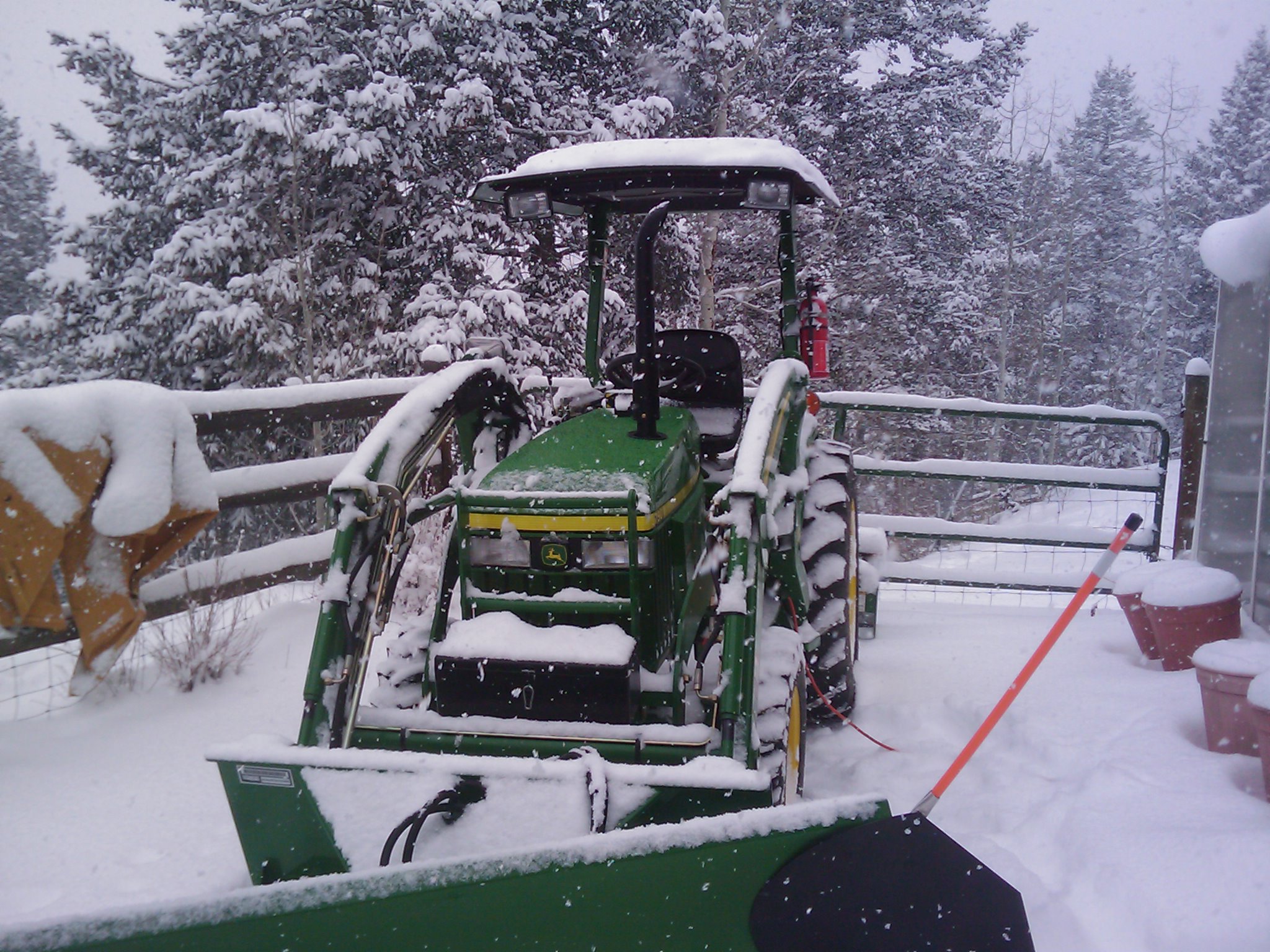

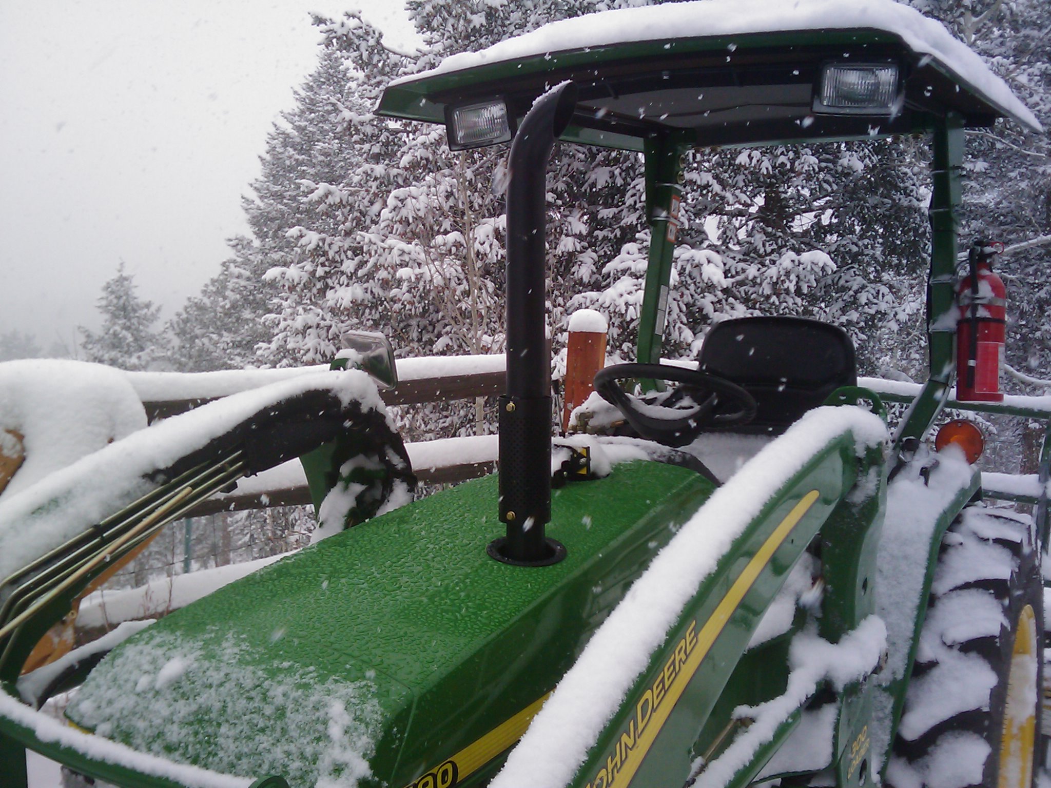

I just plowed snow and I have to say the vertical exhaust seems quieter. I think because there is a short mostly straight path for the exhaust there is very little sound coming from there. The biggest noise now seems to be from the engine itself. I have the exhaust turned to the side the exhaust is on and I think I will keep it like that. I'm happy with it.
Included a couple more pictures that I just took with my phone.

Here's a couple of pics of how the vertical exhaust lifts off so you can open the hood.
Sincerely, Dirt

I haven't driven it, just started it after I finished the install. I suspect I will point it to the side or maybe front. The vertical exhaust is much larger in diameter than the horizontal and a shorter run so it isn't as much back pressure. It seems to be quieter and has a more throaty sound. The extension cord goes to my block heater which since we are near 6" of snow will be used this morning.
I don't expect to smell much fumes. The exhaust is now the configuration of every tractor I've ever driven until this one and its never been a major problem before.
Your going to want to point off the left side, this will keep it out of your face
Tom
