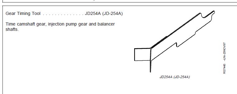

HI, I have a 2510 John deere, and im rebuildig the motor but I dont know how to time it, I searched for the timing dots but couldnt find it how do I do it?

If you're trying to time the frt timing gears it requires a special tool.

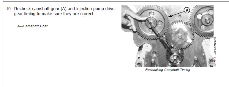

First picture is the tool, you could make this. Second picture shows tool in use, timing the cam, timing mark on cam gear is approx. 5 o'clock tool crosses the timing mark and center of cam shaft. Crank shaft is #1 piston at TDC

First set your crank shaft to #1 piston at TDC. Use the tool to line up the center of the crankshaft with the center of the shaft you are timing. Timing mark will be on the line BETWEEN the two center lines (crank shaft center line and shaft you are timing). You need to time the cam shaft, each balance shaft and the drive gear for inj pump.
