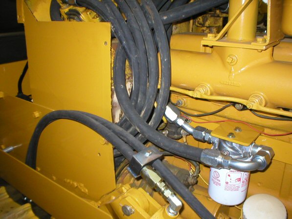

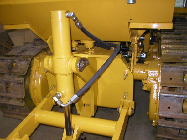

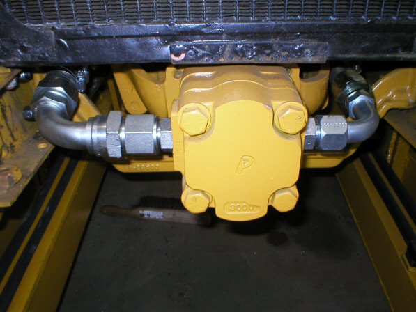

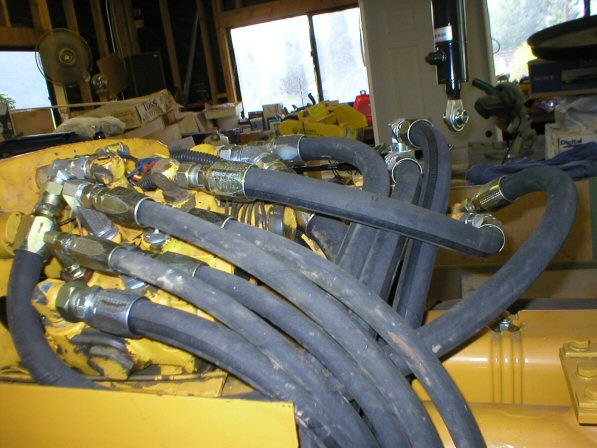

Not trying to be a smart guy here, just want it to be right when some noobie searches. Once the fitting has been removed, the hose should have the end cut off before a fitting is installed again.

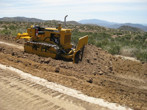

I completely re-plumbed my Case 310 dozer with these fittings. Trust me, the larger fittings are not cheap. :eek:

As a newbie, thanks for the tutorial, KennyD.
Great looking Case, MtnViewRanch. You've obviously got a lot of work into it.
