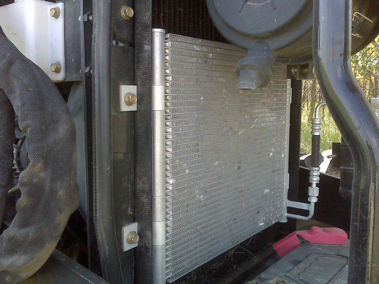

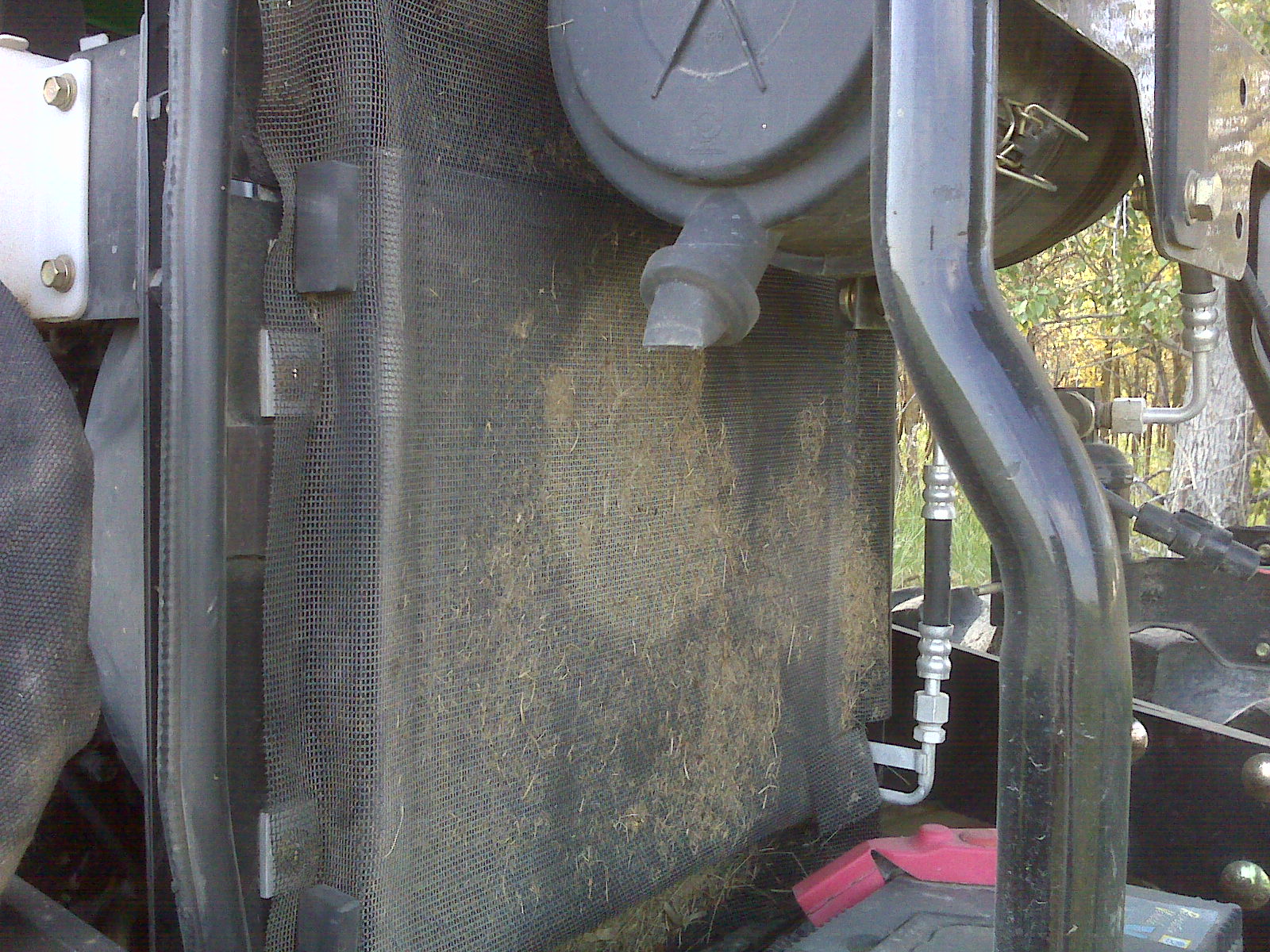

I think I may have finally found the max ability for our 5740C when working.:):eek: Let me just say that growing up on a dairy farm we typically were "over tractored" on many of the balers, haybines etc we used so I'm not sure I ever witnessed this before. I started seeing the low oil pressure light coming on when I slowed down the engine while hot to 1000rpm or so until it cooled a bit. Took it in to the new local dealer. They were able to reproduce the problem and found we had lots of oil pressure when cool and at idle. They diagnosed oil too hot, breaking down. (I am using a conventional diesel oil 15w40) They found the rad to be plugged with debris.(I'm still not a believer on that) as I use a screen 100% of the time, but they cleaned it and it does run cooler and didn't have the problem anymore:). I was tearing up some fresh ground with a 200cm(6.5') tiller and was able to push it until the problem showed up again:mad:. This is just 2 hours after carefully blowing out the rad after my last use. Thinking I was plugged up again I popped the hood and still quite clean. It suddenly occurred to me perhaps I was working it too hard;), slowed down a speed and problem solved, no creeping temp guage, all better. Running out of summer here, but 2 things have occurred to me to test next summer, 1)different oil, 2) turn off A/C.
Unfortunately we will be out of warranty in the spring next year, but I feel much more confident that at least there is not a mechanical/design issue with our tractor.
Thanks, just posted for info.

The radiator itself seems to get clogged up over time, even with using the screen all the time. In our Texas heat, I've noticed that while mowing pastures, as the summer months go on, the temp gauge goes to hot quicker than it did at the start of the mowing. When you blew out your radiator, I assume they took off your A/C since the radiator can't really be completely blown out with it still on there.
   / Reached the limit
Yes they pulled it apart. I'm thinking the rad may be just a little on the small side for the work the powerplant is capable of. Did a couple more hours on it today with the tiller in some looser soil and it worked perfectly even though it was quite warm outside. I think the power of the motor may be leading me to push it too hard in the tough going.

Thanks for the suggestions guys, the air cleaners are both newer and I blow them out daily. I actually don't think our conditions are much different than anywhere else. Routine maintenance is a big part of my daily use, its the way I grew up( all my dad's tractors had over 10 000 hrs before a newer one was considered). I did make a mistake assuming the screen on the rad was good enough. Seeing lots of moisture over the winter with the snowblower really probably caked in any leftover dust/dirt there. I now realize that the rad needs to be blown out at the end of every day with the compressor and I have an attachment I can use. I think mother nature may have solved the problems for us until next spring anyway. Wet, temps in the 40's, no warmer temps likely any more this year.;)
