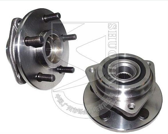

That reminded me of one I recently changed. For a table it would still work fine.
Jeep hub from about mid 80's onward.
