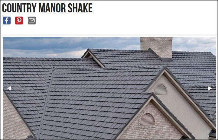

When I got roof quotes about 2 years ago, there wasn’t much difference between shingles and a screw down metal roof. Standing seam different situation.
Like others said, it depends on the type of metal roofing.
For sure this did cost a lot more than asphalt shingles, but that was 20 years ago and it still looks like new!
