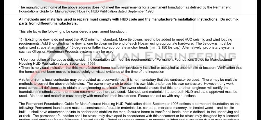

Got some news; and maybe a clarification. Apparently it was the structural engineer this Wednesday and appraisal is next Monday. So, Apparently the engineer is requiring 8 additional hurricane straps, and the home inspector won't pass a water heater over 25 years old, so the buyer can't get insurance...
I asked the real estate folks; ok, first how much and 2nd who? on hurricane tie downs? Next, I'm not doing either straps or water heater until I have a complete list and passing appraisal. I want one complete punchlist, before I decide on doing the repairs.

I did some reading, and apparently there was a definition change in 1996, on what was legally considered a permanent foundation, and this home was from 1994; so that explains the tie downs...

BTW, of coarse the home had tie downs. It's the lack of 8 "longitudinal" tie downs. My real estate folks looked briefly into it, cause they had seen this before, and found two recommended contractors that are "fairly affordable".
Water heater, i think I will likely pull a permit and do myself, although, I got to reread that "homeowner builder affidavit". It might include a line about not selling for 1 year?
