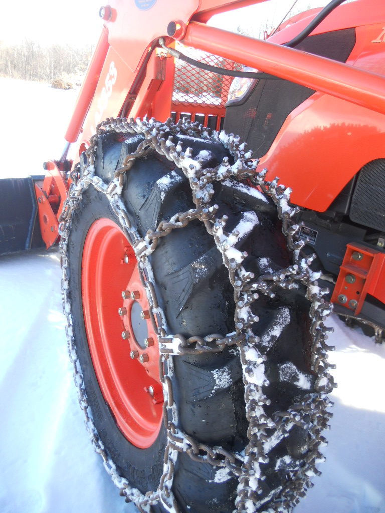

You might keep an eye out this summer for some "serious" ice (studded) chains for the front. I put my 102" (Snow Wolf) blade on my 5 ton tractor and when angling the blade in deep or medium to wet snow, pushed the front end away from the plowing direction dramatically. There is too much distance (leverage) between the leading edge of an angled plow to the front tires, easily 7-8'. The pictured chains I have helped a lot but does not eliminate this issue. This push can be minimized by lifting the blade out of (loader arm) float position but this will require you to make a second pass for a clean scraping. But you'll love it esp. for stacking!:cool2:

If any chain deserves to be called badazz... those are badazz chains.:thumbsup:

They are ice magnets!!! A friend turned me on to them. I think they are Trygg brand. I've only had them for a month or so and am still like a kid with playing cards & clothespins on his bicycle spokes!

Good info.I will keep my eye out for a set.Thanks,

They must raise he!! with an asphalt drive
