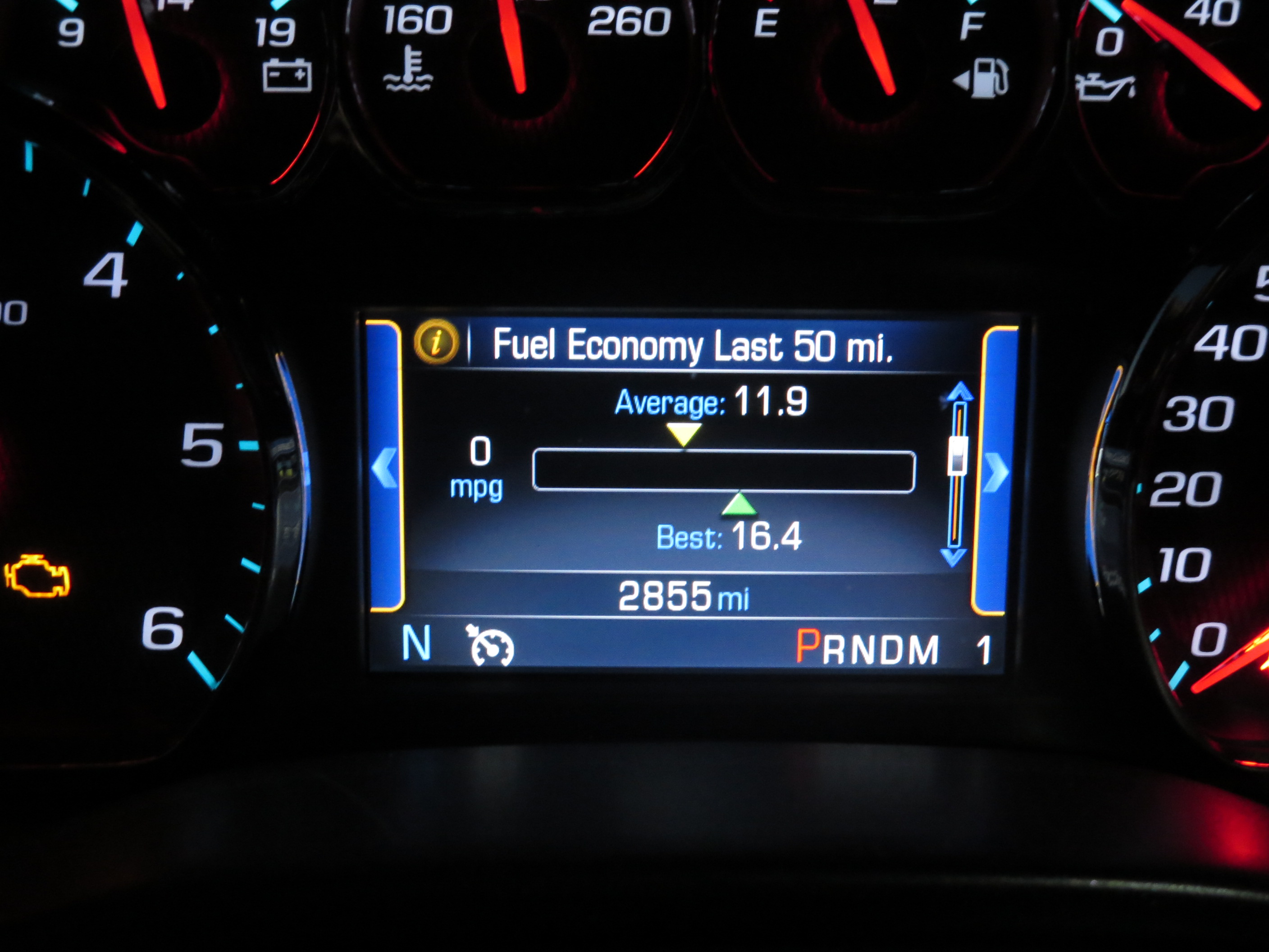

Had my 2015 Silverado Z71 3500 6.0 long bed double cab 4X4 for about 6 months now.
Not sure how accurate but it's currently showing this.
Had a bumper pull dump trailer with a load of old concrete and pulled on the scales and had a max (or a tad more) GCWR and pulled it very well for a gasser.
