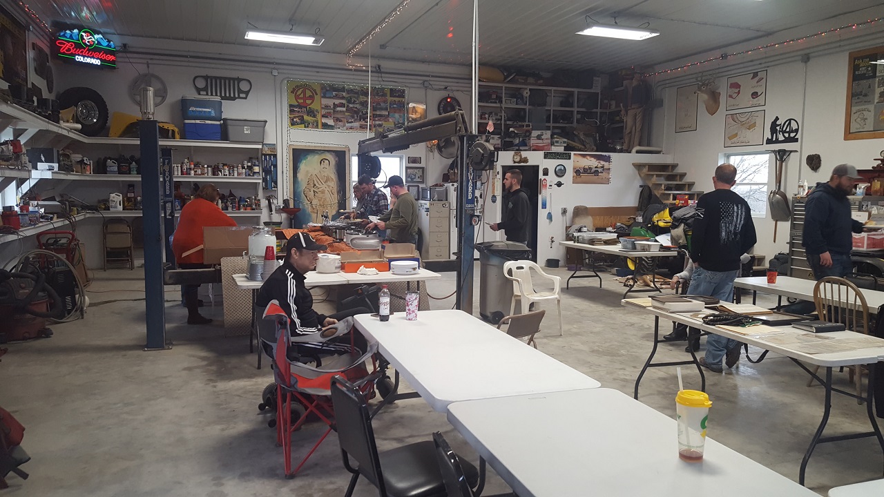

Bonus to a 4 post is it makes an awesome buffet table!!!!
