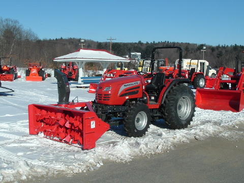

I saw this pic on a dealer's website in Vermont & thought of this thread. If it were me, after using a blower (3pth) vs. a plow, I'd go for the blower, but in this situation it would be front mount. Cab's are nice but, pricey. I'd dress as I would for sledding.
