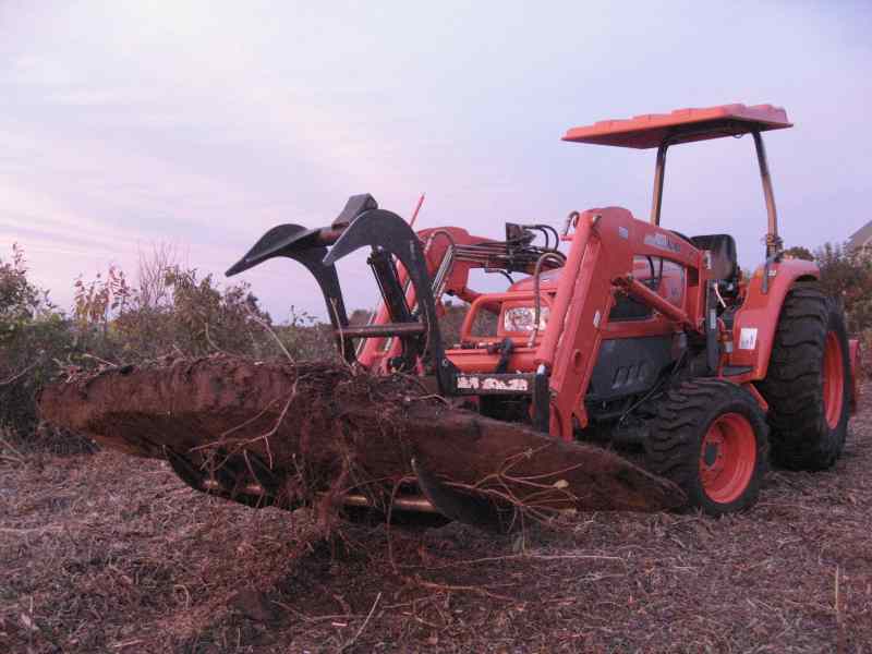

I agree, load the tires. I did not get loaded tires on my DK40se due to a concern about excessive weight on an old barn floor where I store the tractor. I now regret that as my loader can lift considerably more than I can balance with just a 500lb implement on the 3PT. I can easily put some planks down on the barn floor to distribute weight but I didn't think of that when ordering the tractor.
Yesterday I picked up a big rock (photo) and had to keep it almost on the ground as I moved it as my rear wheels kept coming off the ground. Not a pleasant sensation. You can see the left rear tire is almost off the ground in the photo.
I may end up loading some RimGuard myself one of these days unless I can find a decent price on some wheel weights.
