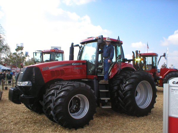

Here's a small one that we saw at the Ag show. My brother in the pic next to the disk and me on my next new tractor. Just dreaming.:D
Hahaha! LOL! Yeah, that'll git 'r done!!:D
