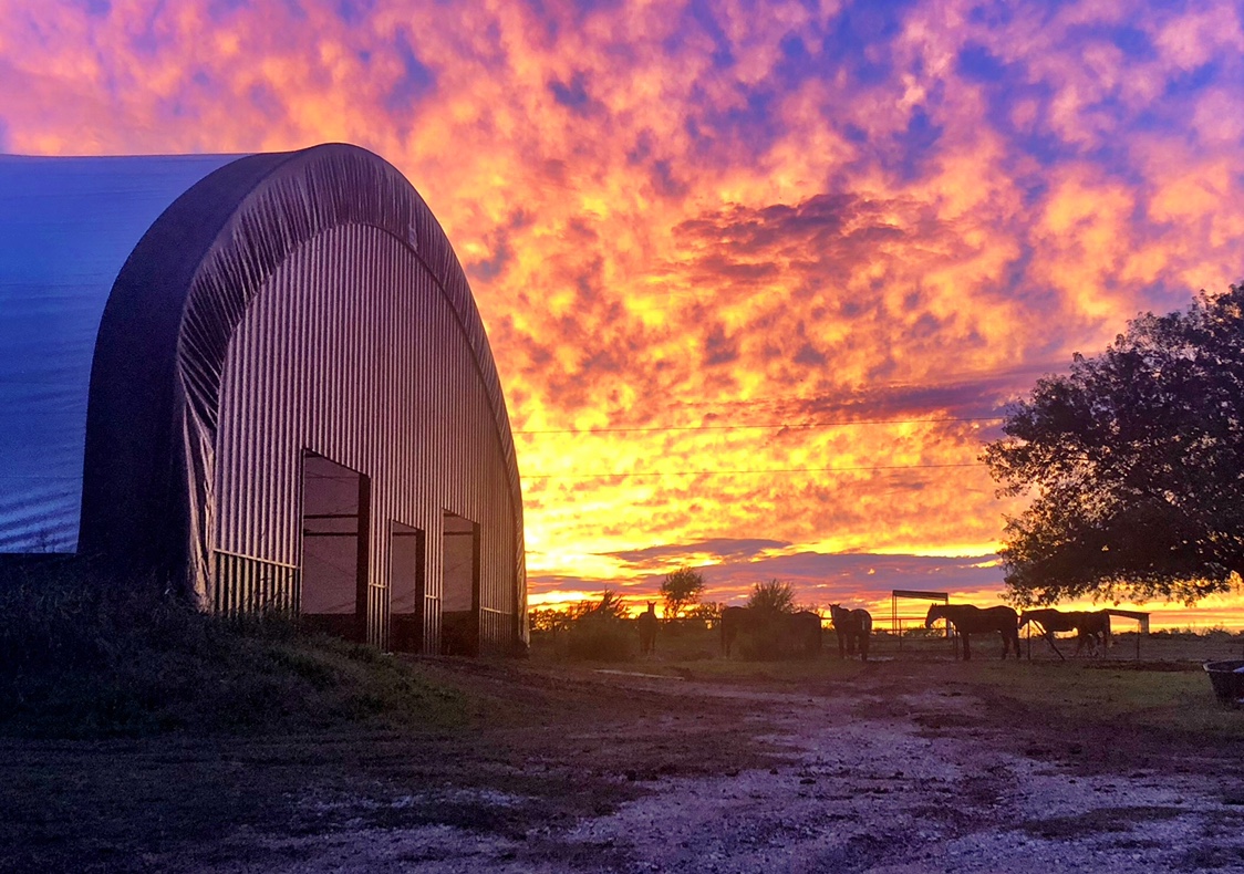

I have a 72’ x 300’ building (indoor arena and barn. My entire property slopes from the southwest down to the north east so we had to build up the whole north 72’ end quite a bit. The difference between the east and west corners is about 7’. Since there will be 2 aisle ways, we have 2 entrances. Obviously the NE entrance is much steeper which we’d like to fix, but first I have to put in some sort of culvert to allow the ditch along the west side of the building a place to drain without funneling it into storage sheds.
We’re talking probably a 90’ long culvert that has to withstand tractors and such. Culverts are so dang expensive! A 12” x 20’ HDPE corrugated pipe is like $250 and it probably needs to be a bigger diameter than that too. Any cheaper options?

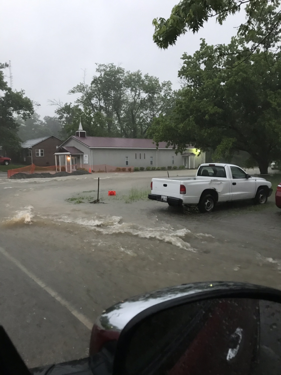

Here’s a picture I took of a job I was going to do. After I decided the 4’ culvert they wanted was grossly inadequate I decided to pass. I don’t know how much water fell that night but it was a lot. IMG_6858.JPGIMG_6859.JPG
/ Really long culvert ideas? #15
The only proper way to size a culvert is to analyze the drainage area. It may be worth finding someone who specializes in this (a civil engineer) or someone who does site development. Looking around the area or arbitrarily choosing a culvert size is guessing at best. You may be surprised at how much water a 6" smooth walled pipe will move. I'm very skeptical that a 12" pipe is needed around a building but I'm not there nor have i done an analysis. Eddie is correct about needing some fall to scour the pipe to keep it clean unless you have inlet protection for it. Access ports would be a good idea if you start getting over 100' long. Water has a funny way of being a pay me now or pay me later type deal.
