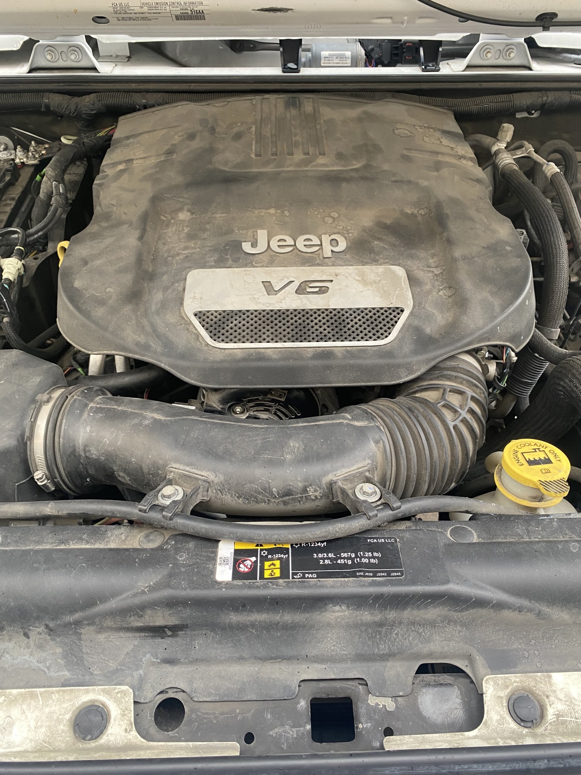

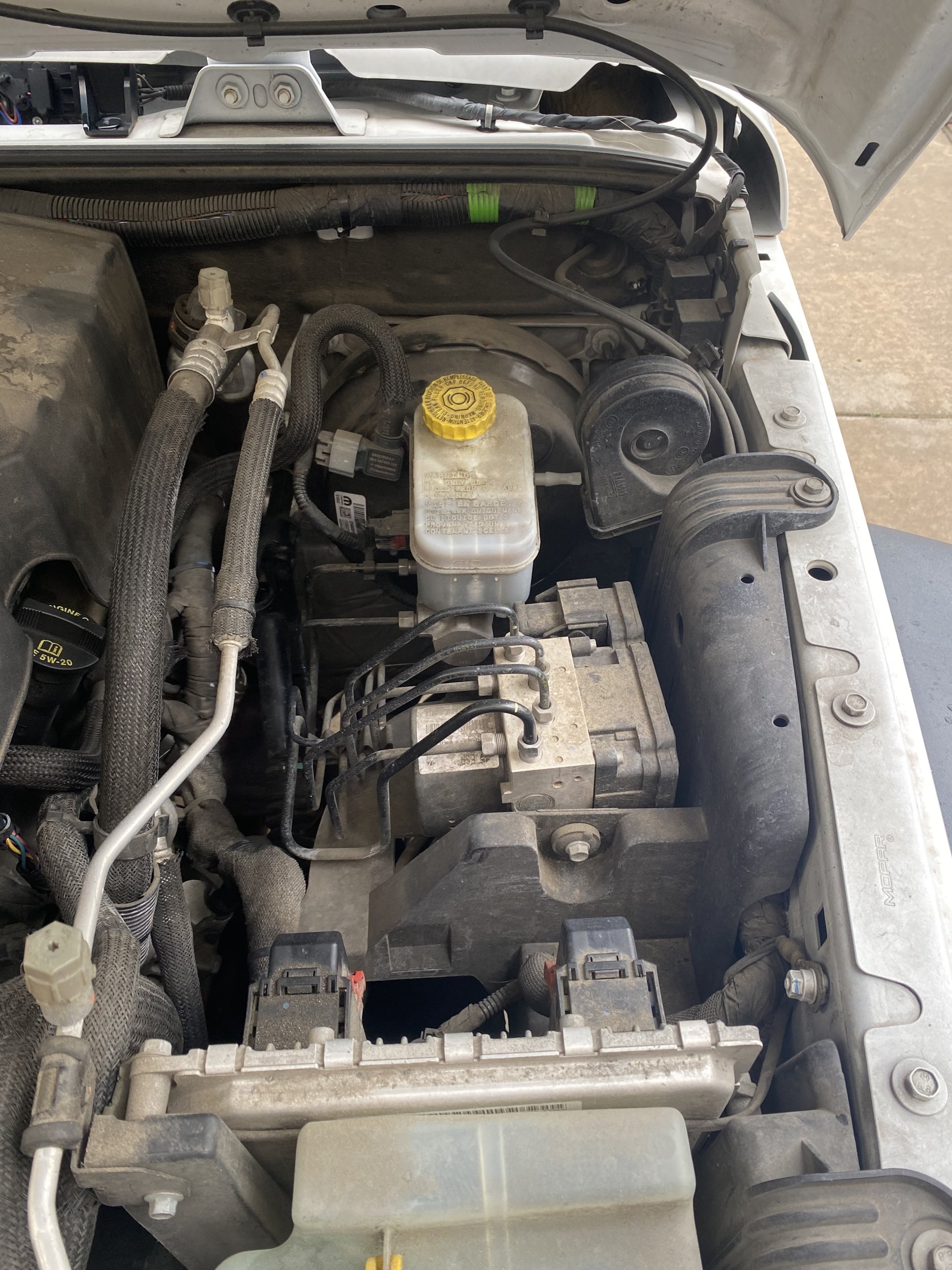

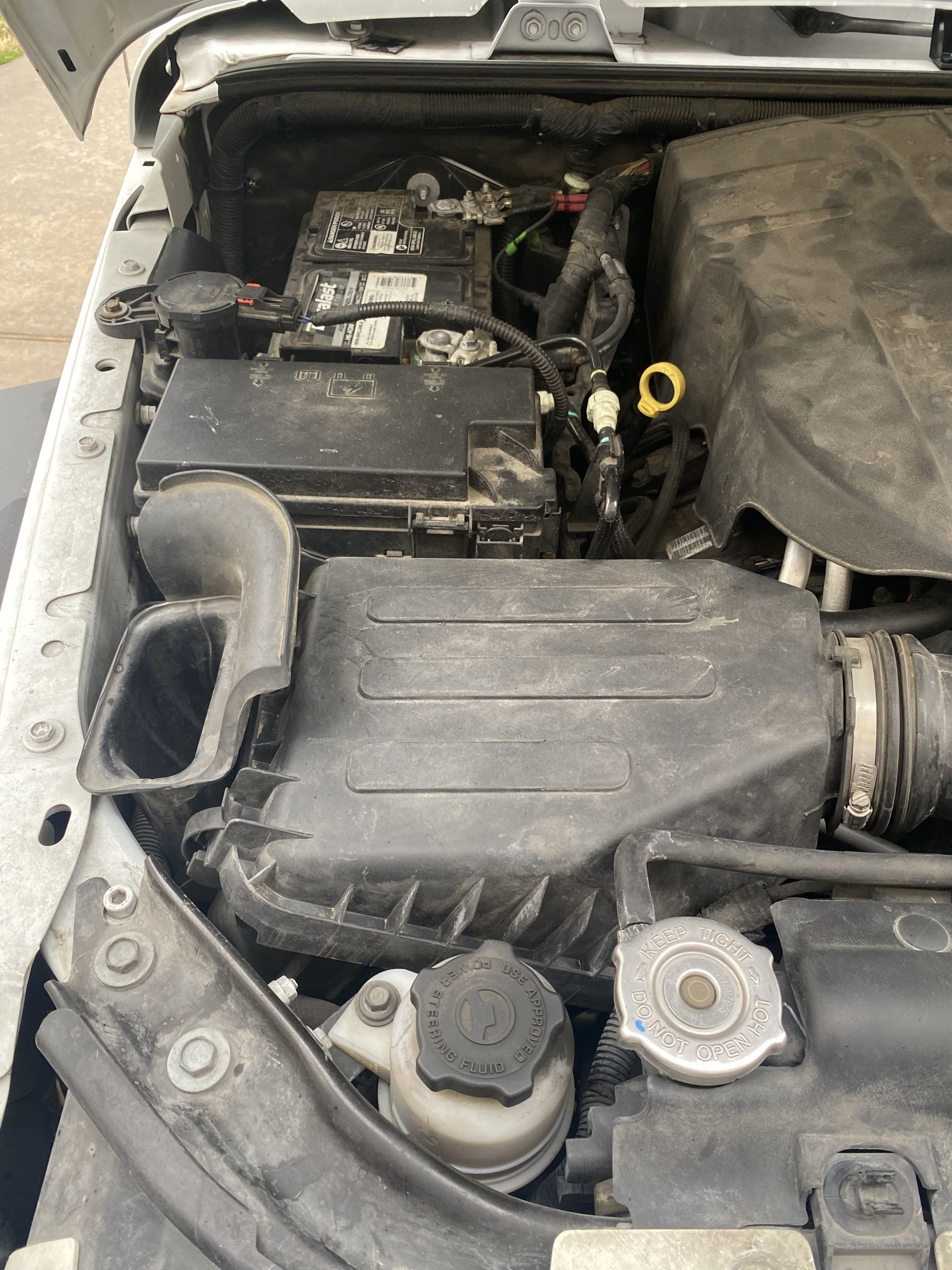

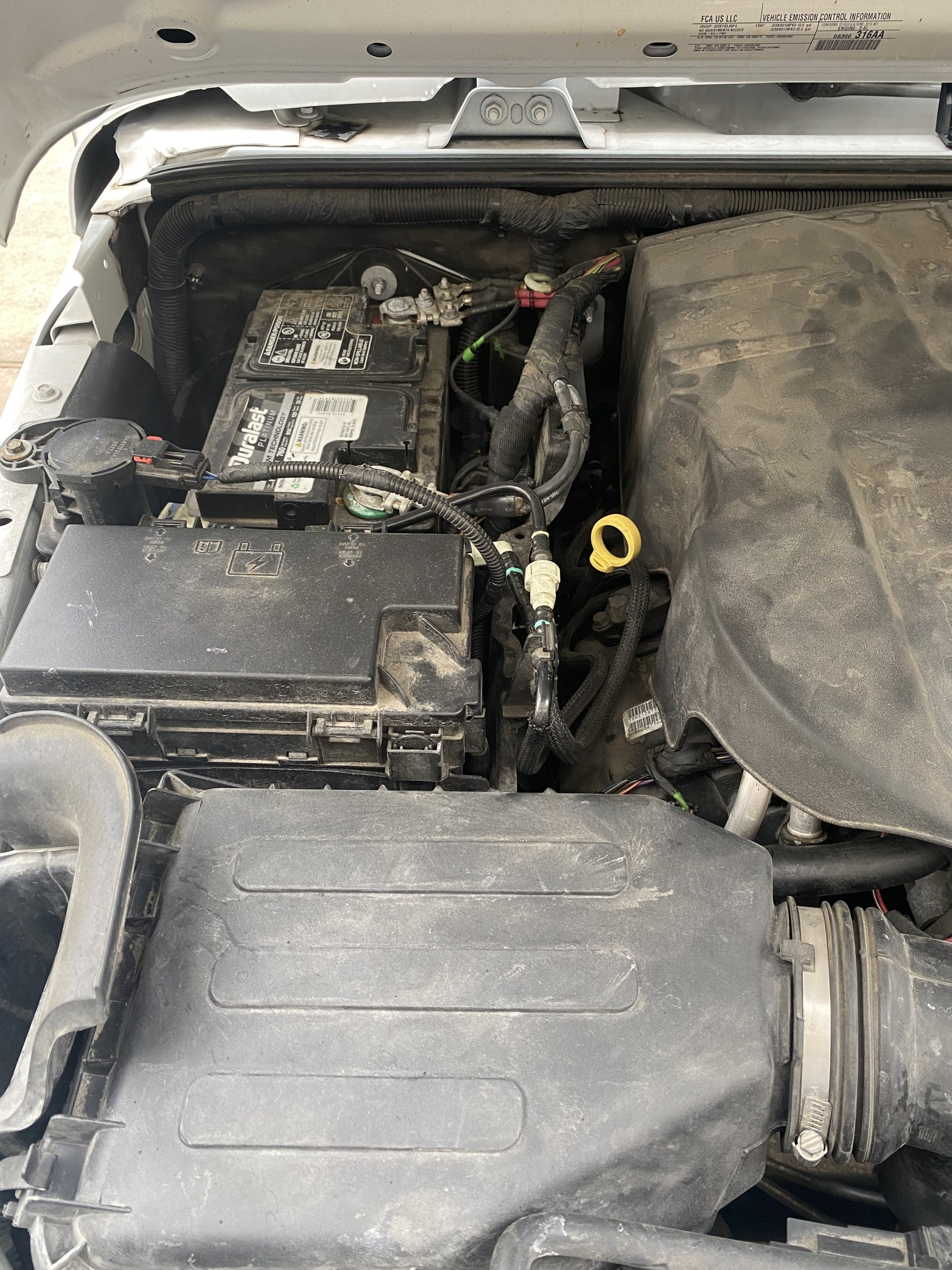

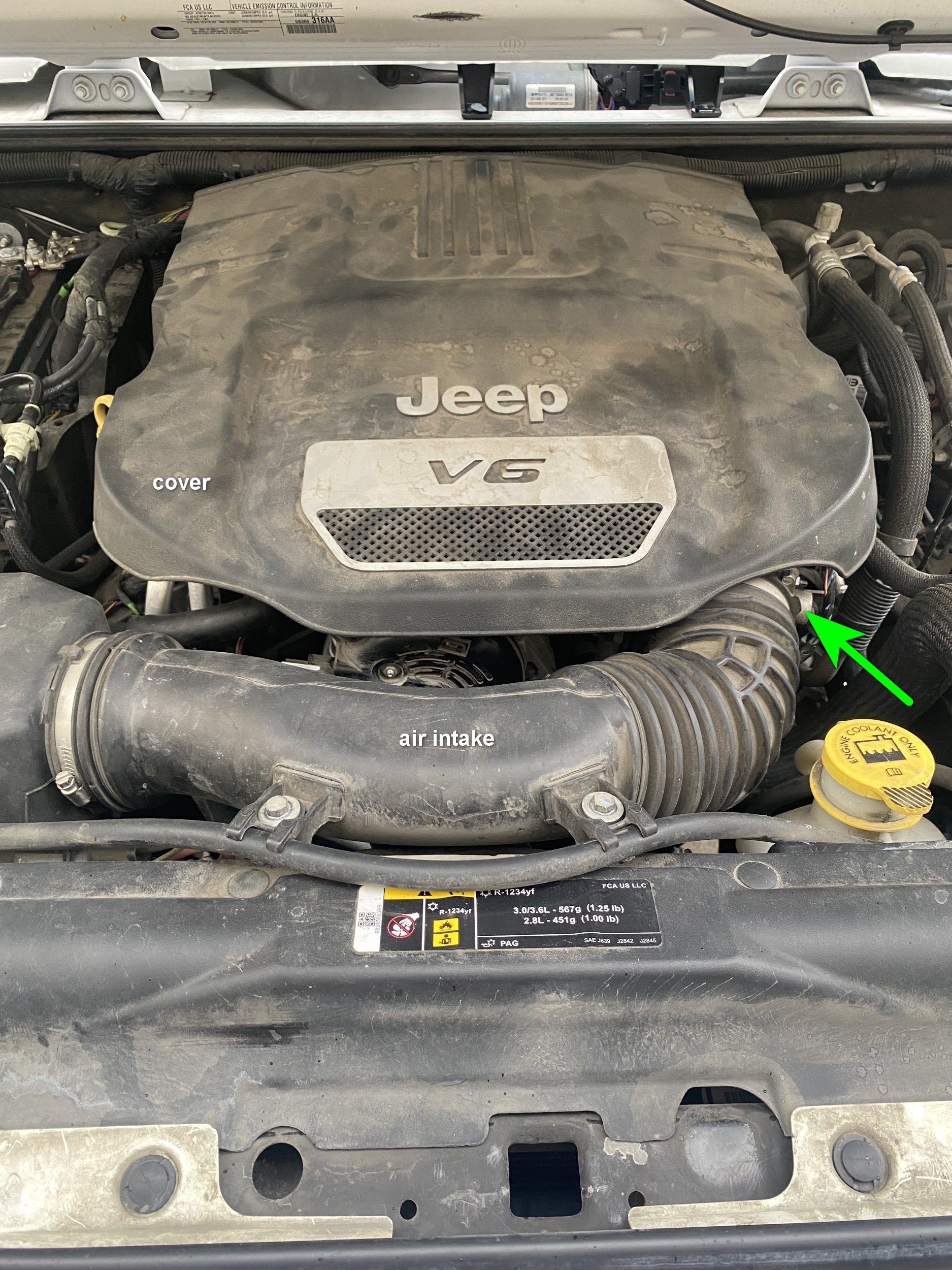

Here’s some pics of engine. Re vacuum
Hose(s), can someone point me in the rt direction? Thank you

Vacuum leaks are a pain. You'll probably have to get that engine cover that says Jeep V6 removed so that you can actually see the top of the engine.
Vacuum hoses are often tiny black hard plastic hoses about say 1/8" to 3/16" in outside diameter. About the size of smaller electrical wires.
They may go from the intake manifold to the ignition system (which is all covered under the Jeep V6 cover).
   / Really need your advice whether my daughters car is safe to drive or not as she needs to return to school later this morning #18
Look at the air intake to be sure it isn't cracked somewhere, especially the accordion sections. I doubt this is where the problem is.
Remove the top cover so you can check the hoses underneath it.
The air intake runs directly into the throttle body which is the metal body next to the green arrow.
Basically, take a look at every hose they'd have to have touched in order to replace or work on the throttle body.

It sounds like you're having trouble in the vicinity of the throttle body which is under the top cover. The codes involve TPS throttle position sensors and the MAP sensor Manifold Absolute Pressure sensor. The commentors are correct in saying you should check vacuum lines and connections to the TPS and Map sensors. There could be an intermittent leak or a chafed or loose wire. Make sure you have an adequate light source when examining those items.
It's unlikely that the problem will strand her somewhere. Most of the fault codes will clear after half a dozen operation cycles if the problem is intermittent.
