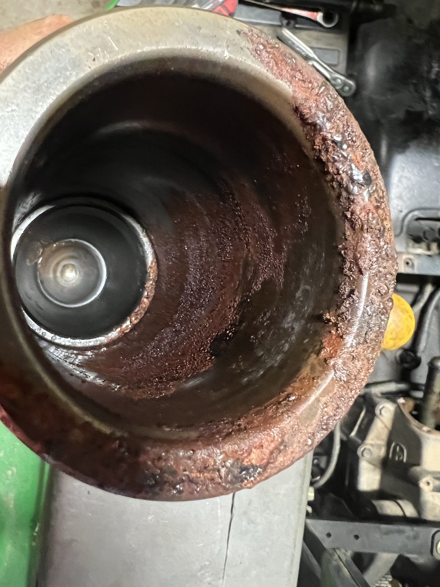

I looked into this a little more. I remove the rockshaft to check on the seal for the piston. It had some rust on one side, used a wire brush to get the shaft and piston clean again. See pic, it’s all clean now though. It may have been frozen from rust as it did not want to move initially. I have gaskets on order.
I then checked to see if the line for the rockshaft was putting out fluid, it was not. This certainly would prevent the rockshaft piston from moving ). I have confirmed that fluid comes into the manifold and the returns ok, these are the three lowest hoses on the bottom of the manifold in the previous photos.
Some questions
1- Would lack of pressure prevent any fluid from coming out of this top line to the rockshaft? I don’t think it would but want to confirm. I don't have a pressure gauge set and there are no quick couplers. Maybe I should get a set if this would aid in troubleshooting? Given that flow is happening in the system and the FEL/power steering work, it appears to be correct.
2- Is there anything in the manifold that could block the fluid from entering the rockshaft feed line?
3- I did adjust the relief valve to increase pressure, but no change on the rockshaft. There are 2 components, the manifold and the control valve. Even though I took apart the control valve, it is possible it’s faulty. I am unsure how, any ideas? Perhaps the springs are out of spec? I am trying to decide if I should get a control valve or get the entire manifold which includes the control valve.
4- Would a bad relief valve cause this behavior even though the FEL/PS work? The relief valve is the second thing to the left of the hole in the second pic, with the allen head top.
Thanks for reading and your feedback.
