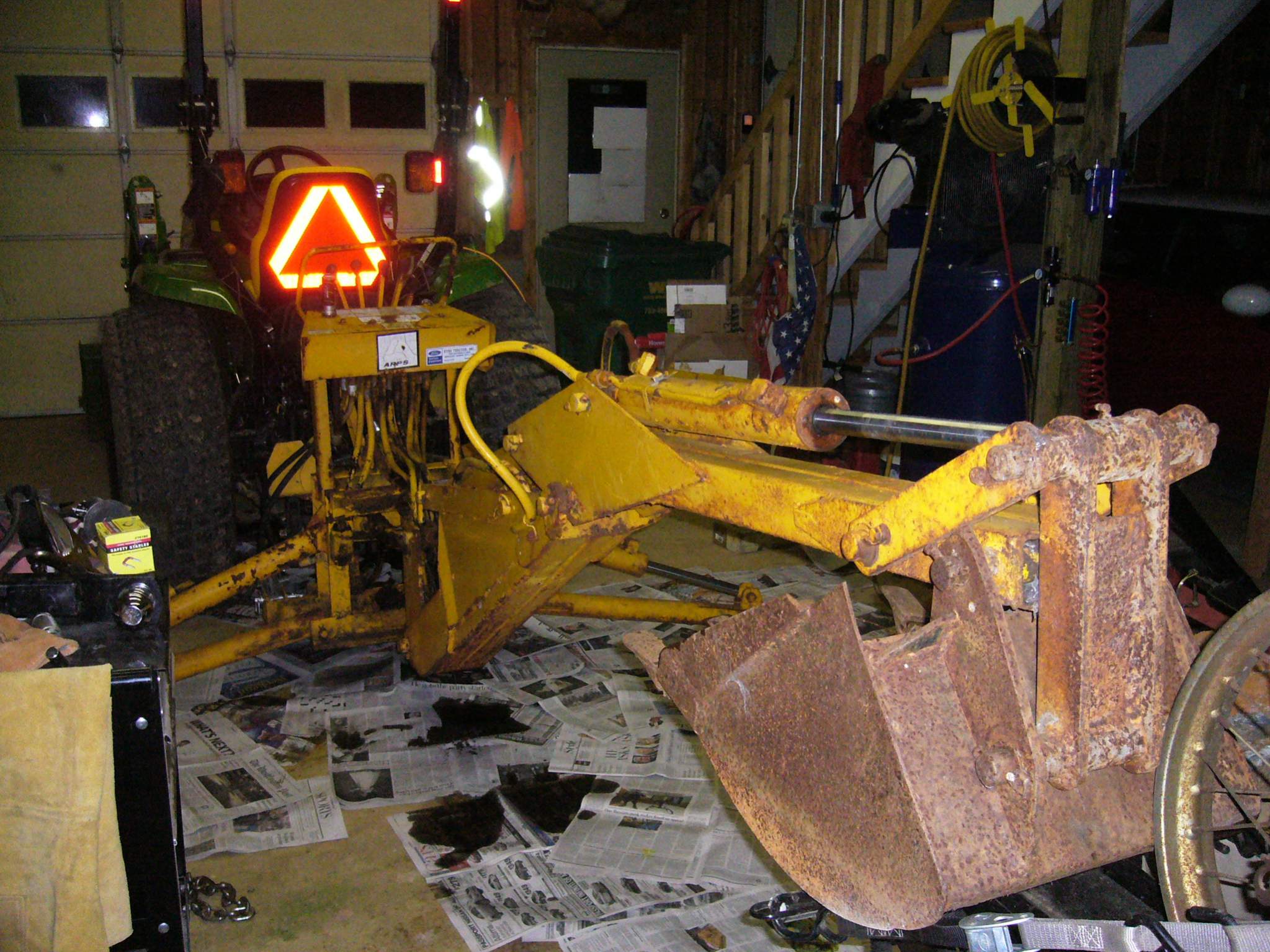

I purchased a used backhoe 2 years ago and tore it apart and rebuilt it. I installed a power beyond system on my 3720 about a year ago and it's working fine (ie, I can use the rear arms and loader, etc, just fine). Tonight I connected the backhoe for the first time and filled the tractor with hydraulic fluid as I moved each arm of the backhoe to get it ready to connect to the tractor. Since it wasn't connected, I couldn't really move the arms that much, but each arm is moving fine and I can move the loader while the backhoe is attached, but I can't lift the rear lift arms? They will go down, but will not go back up until I remove the backhoe and reattach the power beyond system. I know that John deere backhoes (this is an ameriequip backhoe that is a 3pt connection) connect to the subframe and you don't need the rear arms, but I know that the power beyond can control a lot more than a backhoe so the rear lift arms have to be able to work while using the power beyond system.
I monitored the hydraulic fluid while working with the backhoe and added over 3 gallons and I know it's a bit low. But when I disconnected the backhoe, the lift arms worked? Anyone have any ideas???

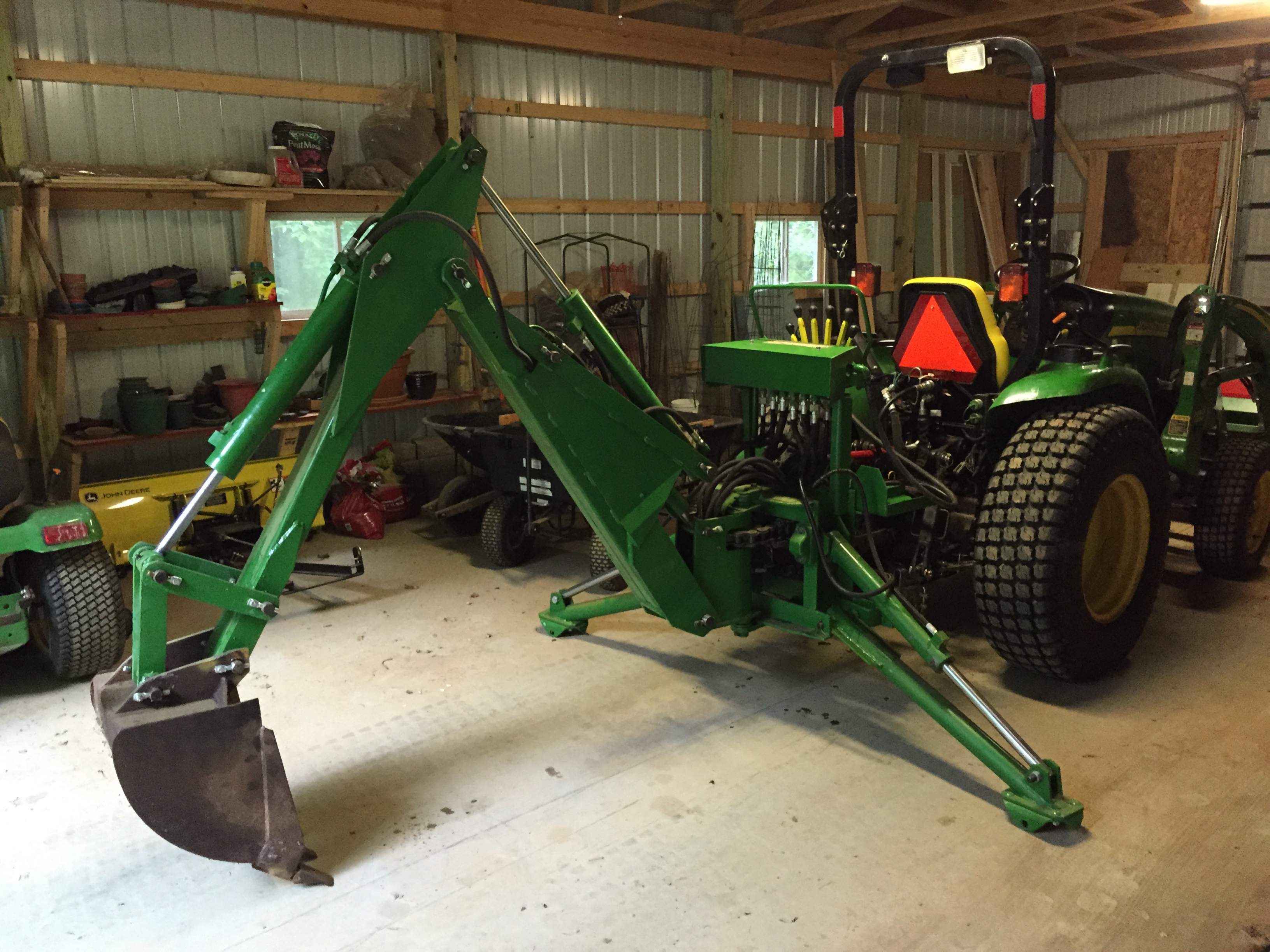

JJ, thanks for the response. My BH is connected to the power beyond on my tractor. I do have a complete flow path back to the tank thru the backhoe. Not sure if the BH has PB, but everything seems to be working great! I just couldn't get the rear arms to lift the backhoe after I had it attached (the PB to the backhoe). So I quit around 2130 last night and posted my question. I got up early and started doing more searching cause I remembered that JD backhoes are now attached to the subframe, so figured the rear arms wouldn't work. I found a video on you tube showing how to connect a JD backhoe and it confirmed the arms won't work after I connect the BH. So this morning I just set the arms low enough to attach to the bh, then lowered the feet on the BH to stabilize it, disconnected the BH, raised the BH about 1' off the ground with the rear arms, then connected the BH again and raised the feet and put in transport mode and it works great! I have to go to work this morning, so probably won't get to start using it till this weekend. Here is a picture of it when I first got it and it in the barn after I finally got it out of the garage after two years!! P1040404.jpgIMG_6629.jpg

Looks good.
Set the BH relief pressure same as the tractor relief valve, or set it higher and then the tractor relief will protect the BH.

The reason that the 3pt would not work when BH connected is that you removed the supply to the 3pt as it is not needed with a sub-frame BH. The pump flow now passes through the BH valve,then to tank.
The lift will always go down using the lever as you are releasing the fluid in the 3pt cyl, but that is only if the descent knob is turned left to open.
