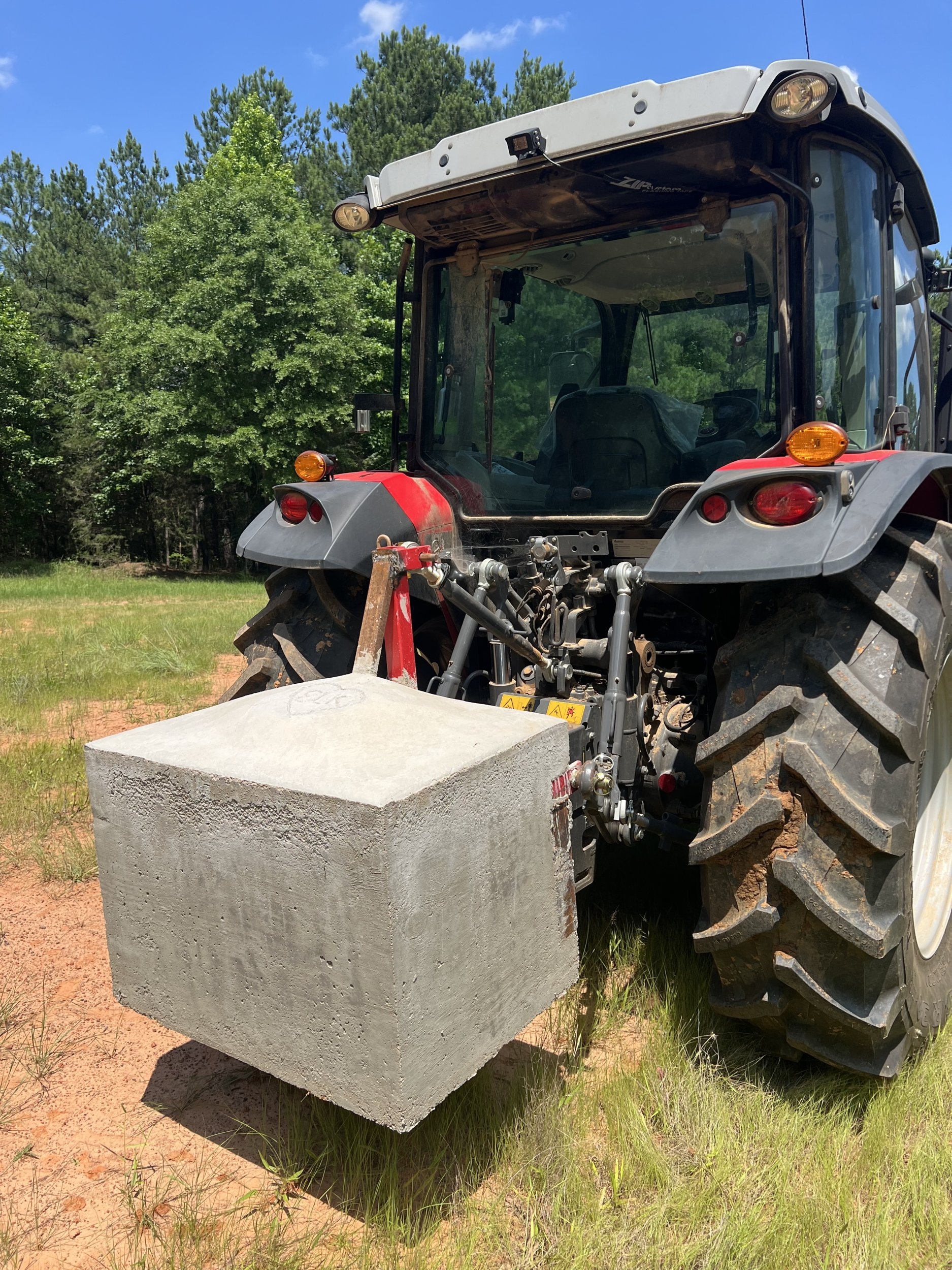

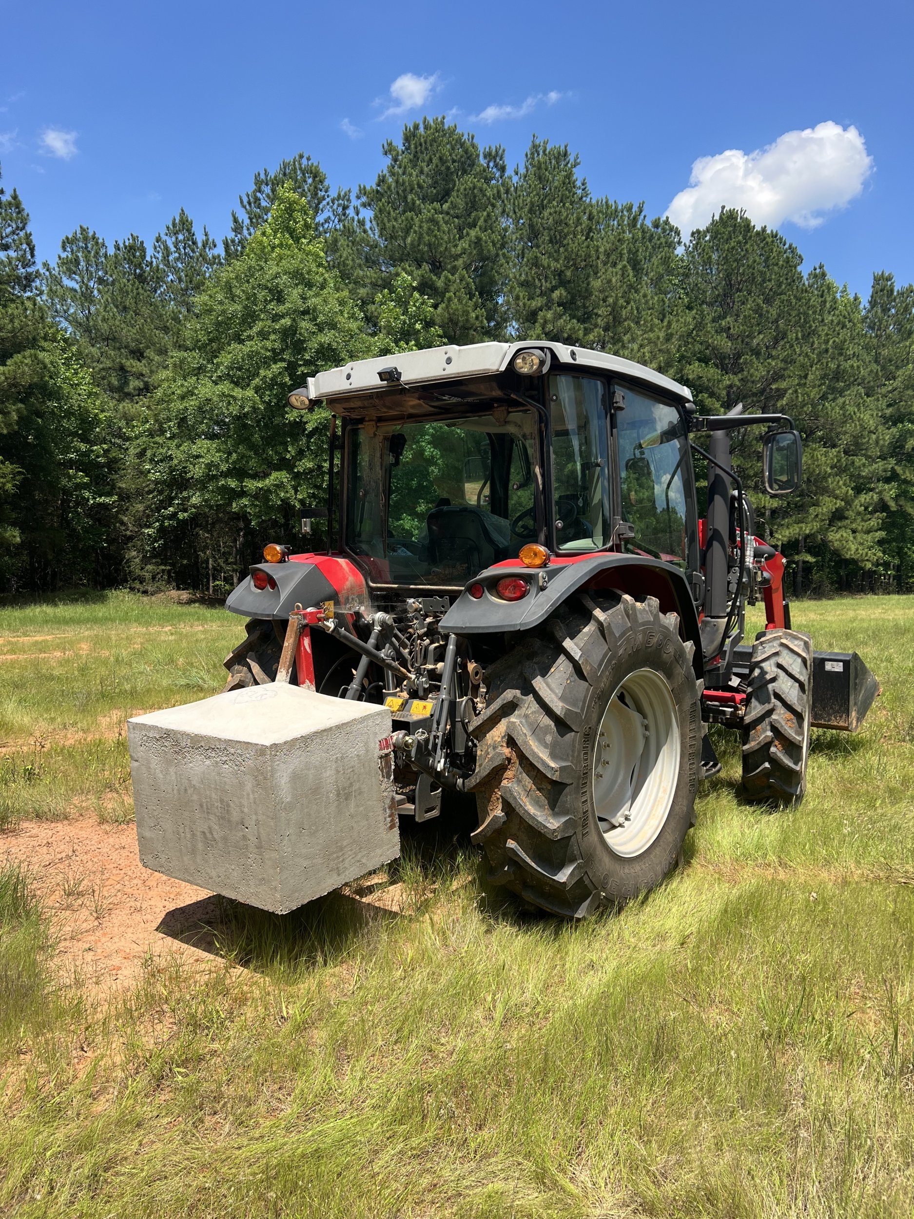

I hooked up the rear ballast today, and took it for a spin.
Right away, just driving down my driveway, I noticed a huge improvement in the ride. It was less bouncy and more comfortable.
I went to a dirt pile that had been there for awhile. I've gotten dozens of bucket loads of dirt from there, but never this easily. It just seemed like I had unlimited power. Zero rear wheel spin, and the tractor just gripped the ground like nothing could stop it!!!!
With a full load of dirt in the loader bucket, I drove to where I had take out some trees yesterday, and started to fill the holes from the root balls. It was angling downhill, and this is where I've had all my issues. A full loader bucket going downhill would lift my rear tires off the ground.
I was glued to the ground. It was more stable, more solid, more comfortable then I ever thought possible. The rear ballast has made my tractor more fun to use, and more powerful, if that's possible. It just goes and goes. There isn't any bounce at all, and I never felt like it was tippy, or scary. I was pointing down hill, and I would even get on weird side angles without any issues.
I'm impressed!!!
View attachment 871222 View attachment 871223

Eddie, I think you will wonder why you didn't do this many years ago.
It's funny, but I've read more posts about rear ballast on here then I can count, and never understood the need. I have a full size backhoe, and the weight of the hoe was my ballast, so I never understood the need for more weight until now.
What surprised me is how much better the ride is just driving on flat ground!!!!

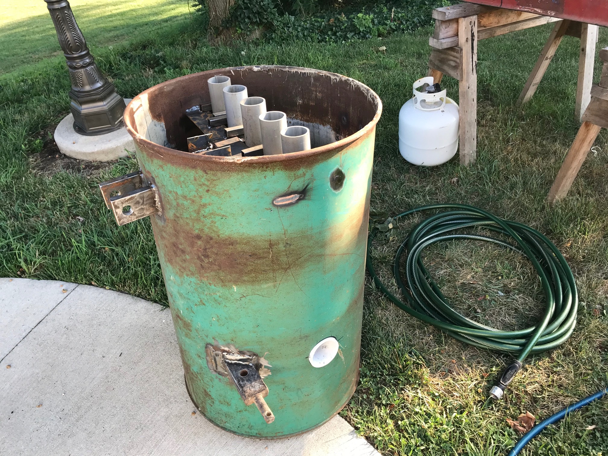

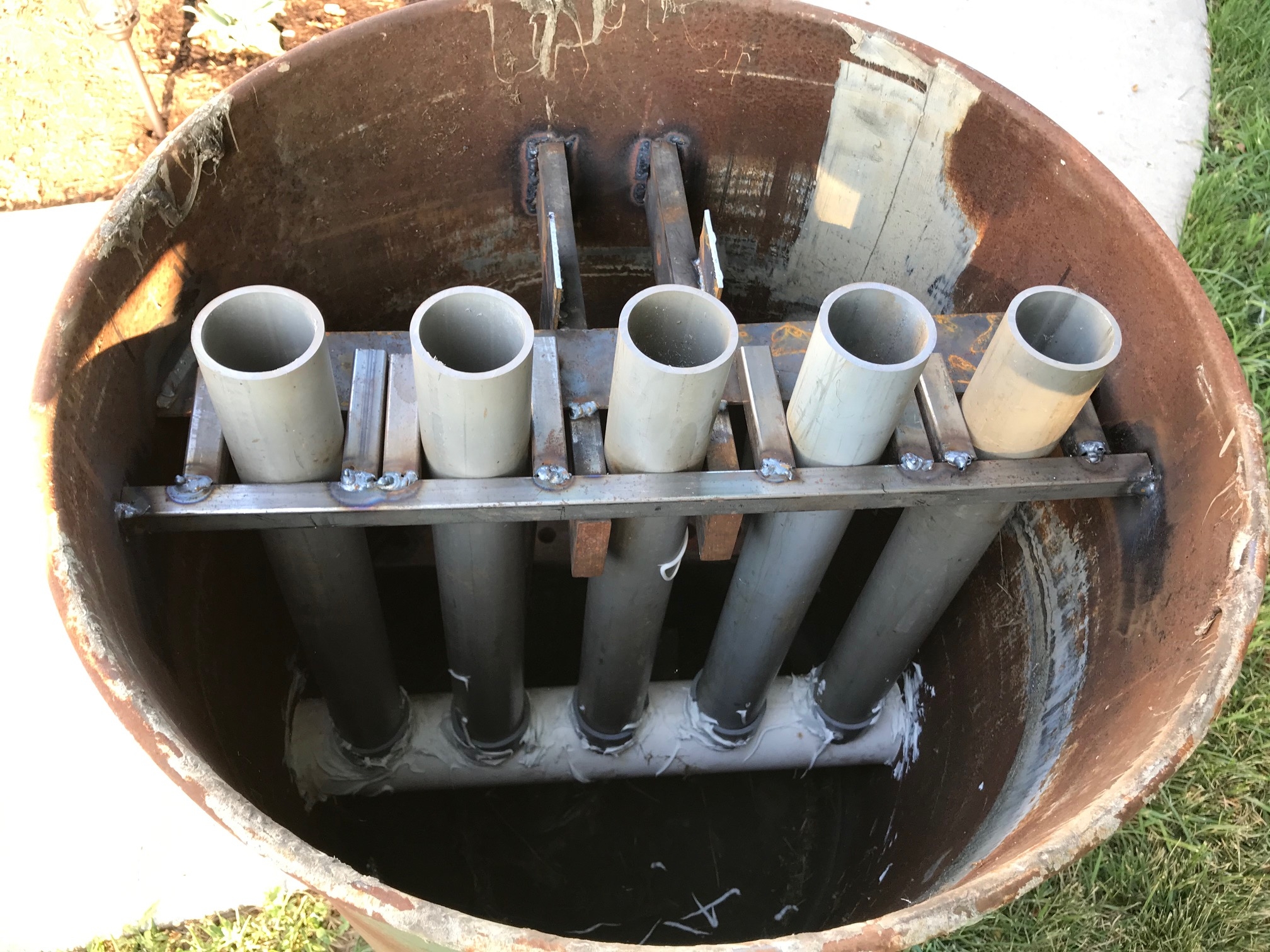

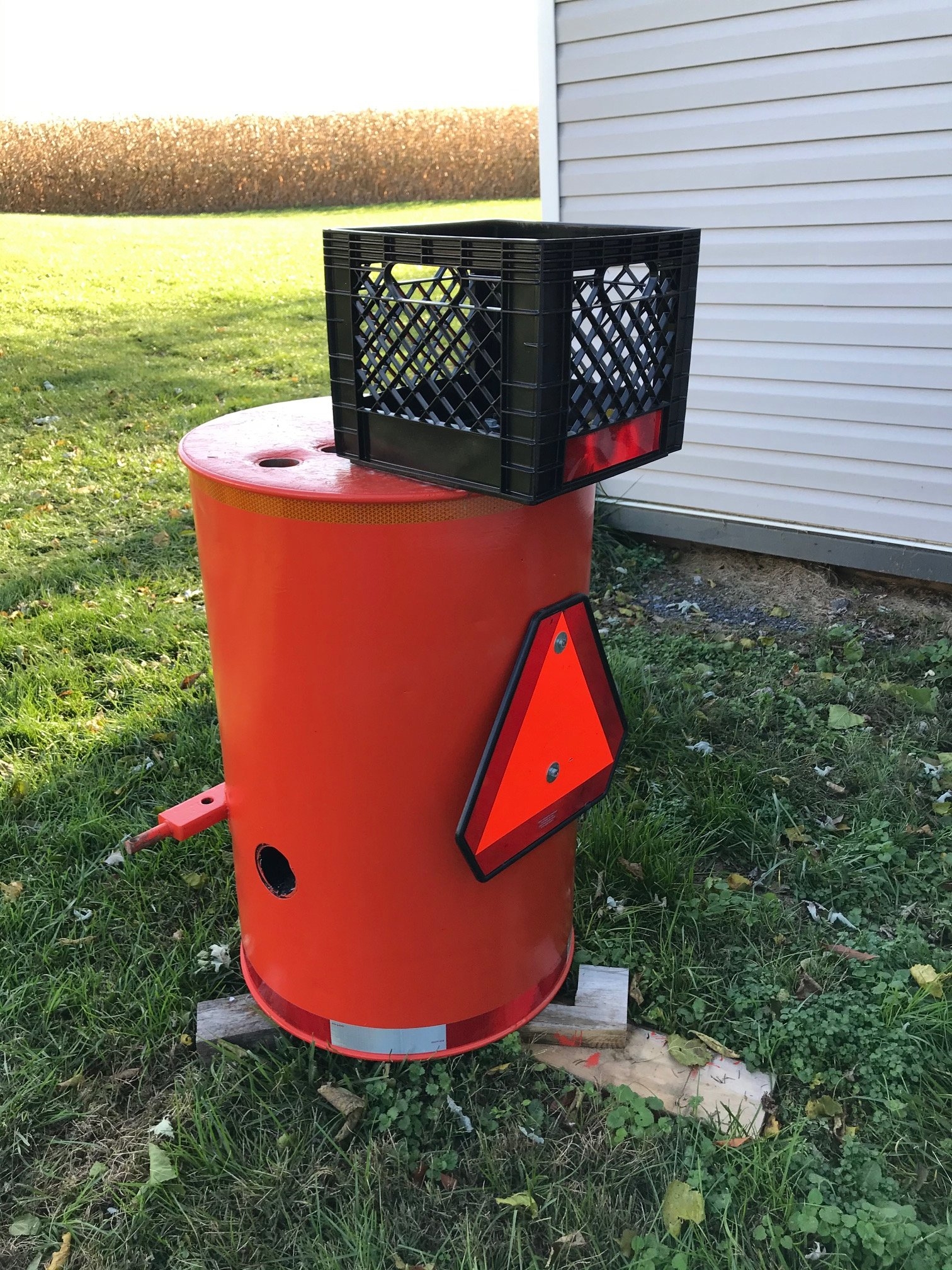

Steel drum. Extra drawbar. Vertical pipes for rakes, shovels, etc. Lower horizontal "header" to swab out whatever falls into the vertical pipes. Milk case for smaller stuff. For occasional relocation a choker is dropped down a pipe and a crowbar or whatever is at hand is inserted into the horizontal pipe through one eye on the choker.

When I built mine, I couldn't think of any reason to put pipes into it for carrying anything. Last weekend, I was moving dirt, and the wet clay was sticking to my bucket. If I had a flat shovel with me, I could of cleaned it out easily. OOPS
   / Rear Ballast Weight DIY Build #69
You can use anchor bolts drilled into the sides to mount PVC pipe, with end caps. Drill a small hole to drain water.
My 1st barrel has pipes for shovels that filled with rain water. I didn't plan for any drain systems so I was able to pull the pipes and add more concrete.
#70
That's a good idea. A flat shovel would come in real handy for cleaning out my loader bucket, and having a place that's out of the way to store it would be ideal!!!
