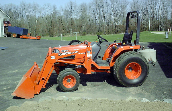

Here is a photo of the weight I made for my B8200 and now use on my B2710. It is made from an old water tank for a well and filled with about 500# of lead. Works well and is very small.

Hey Von,
Where'd you get the lead? Was it expensive???

I used the old lead type from a print shop. I only wanted the cabnets that it came in. So I scraped out the lead and took what I wanted and sold the rest.
