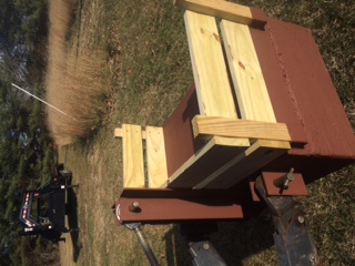

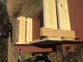

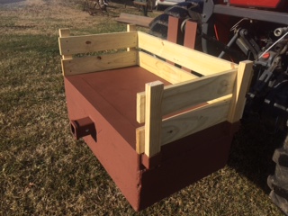

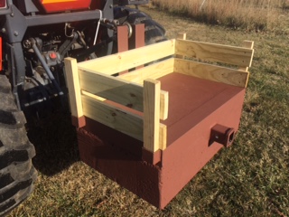

I'm a firm believer in ballast too. I like my mx5100 but it is light for the amount of power it has. So I almost always have some ballast on the hitch just because the traction is so much improved. I do quite a bit of work in tight quarters, around trees, woodpiles, buildings, vehicles, etc, so I don't like keeping a bulky implement on it. My solution is this composite steel/concrete combination ballast box and tool rack. It weighs in at 600 pounds and it makes a big difference in rear wheel traction. Plus I can carry my chainsaw, gas and oil, a toolbox and a chain or two. It is slung low intentionally to keep center of mass low. These pics are before i had used it much.
When I am doing heavy dirt work I put my pallet forks on the 3 point hitch and put on about a quarter of a cord of 4 foot hardwood slung low. That holds me down no problem. IMG_0534.JPGIMG_0535.JPGIMG_0536.JPGIMG_0537.JPG
