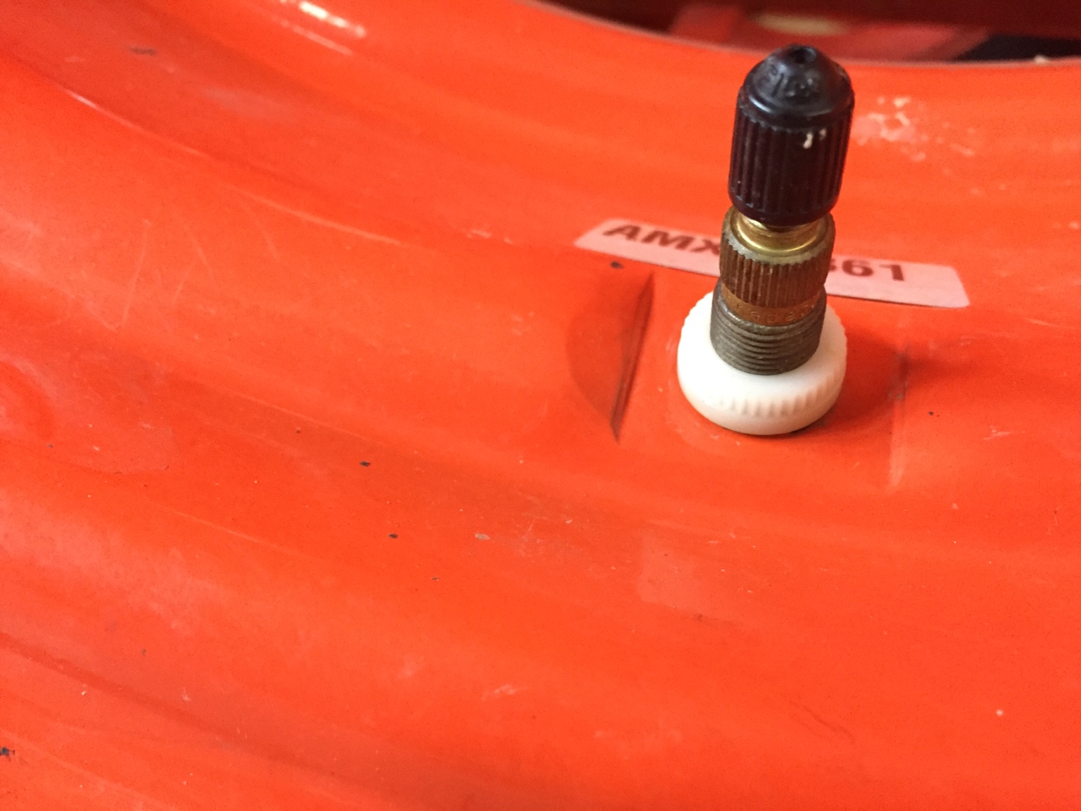

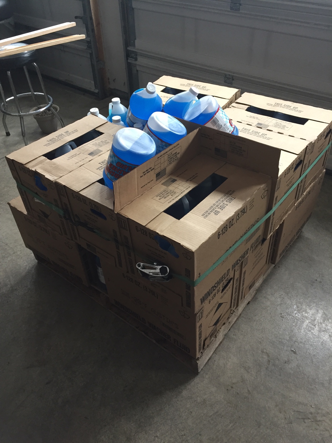

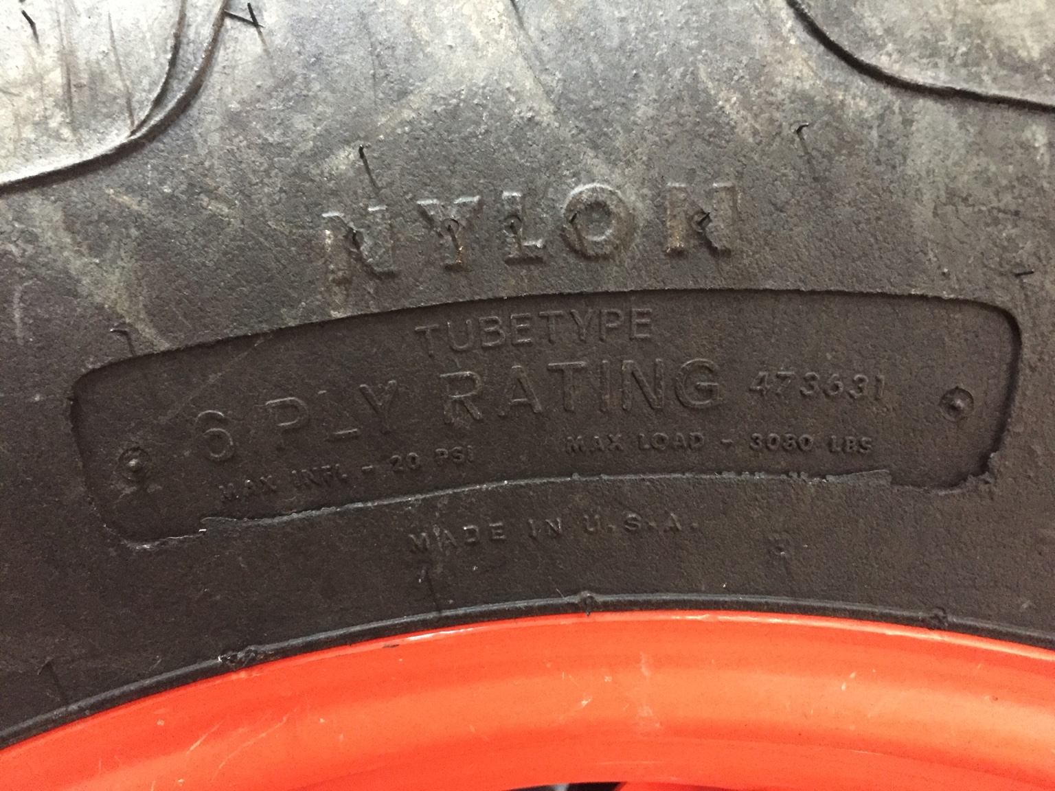

I bought the ww fluid last night and got enough to put the full 48 gallons in each tire. Now just trying to decide if I'm going to put it all in or give a partial fill a try. I looked at my tires and they appear to be tubed.
For fun here is a picture of the ww fluid. View attachment 493214
Can anyone confirm that these are tube tires? Partial first and fill as desired is easier than filling all 48 gallons and having to take it out.
That's a tube stem.
On filling, once you fill to the valve stem in the 12 o'clock position (which is approx 75%), how do you expect to fill more? Using a fill adapter for a water hose, when you stop filling and let the compressed air out, you need to have air at the stem. Otherwise you just blow out the fluid you just inserted.
