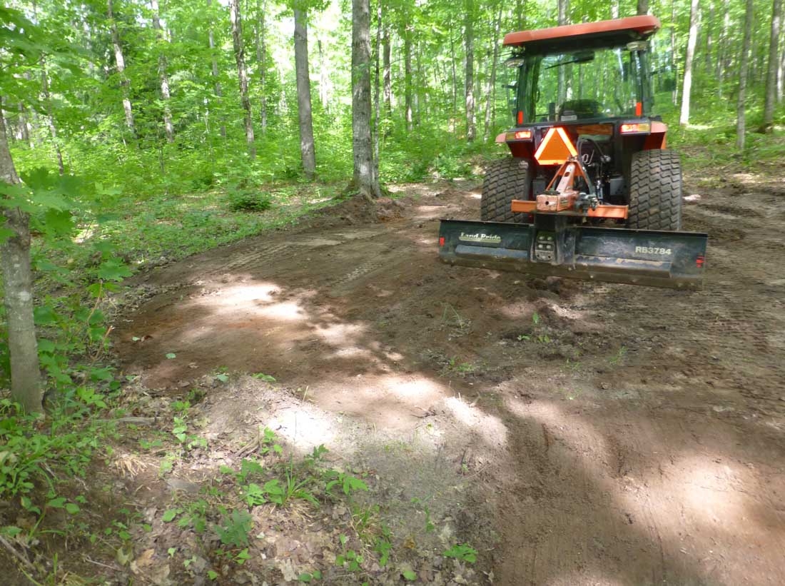

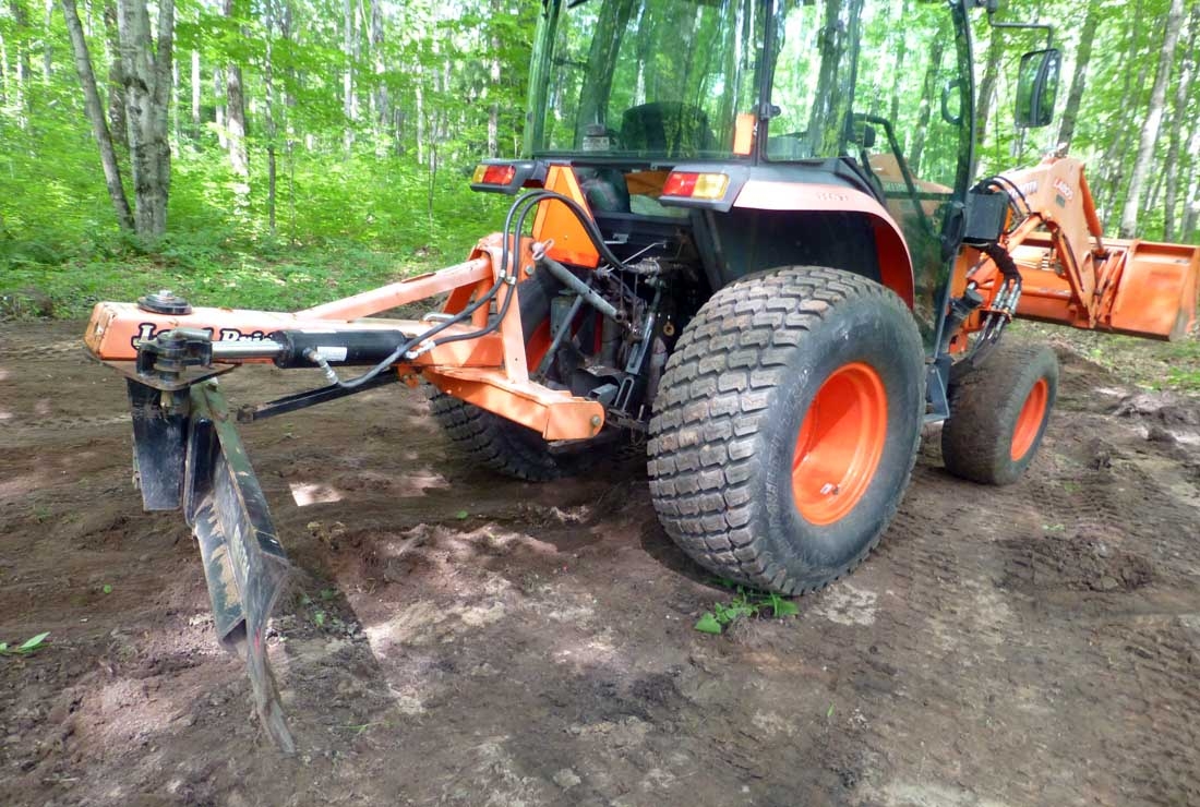

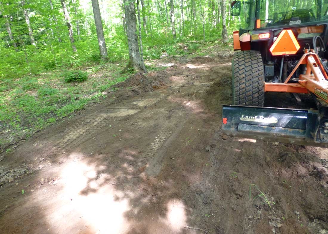

Looking for some ideas on a rear blade. I have a few miles of trails that I need to maintain, the box blade does a great job for the most part, but it leaves the trails dead level side to side which makes rainwater pool and cut channels. So I need some way to crown the trails and I was thinking a rear blade would work, set it at an angle, let it dig with a corner and throw the scarf up onto the trail. Then use the BB to smooth everything out leaving a ditch on both sides. First question, is a rear blade a good/right tool for this? Seems like it should work, but my soil is heavy clay, so.. Next question; how much to spend on this thing? Seems like this is going to be a tough life for a blade (moving virgin soil around), so I was thinking going heavy duty, but, if this is child's play, tell me, and save me some money! ;)
Finally, specific brand recommendations/features? I've got rear remotes, so was interested in getting hydro tilt/angle/offset.. But do I really need all 3?? I'm not sure I need any of them if I'm just cutting a ditch always on the right hand side of the tractor? But I love hydro adjust, so.. Might be worth it.. Adding hydro adjust to my BB (via a top link from Fitrite) has greatly increased it's utility and ease of use, so I don't want to cheap out on the blade just to find that I really should have gotten hydro because I wind up adjusting it all the time.
I've been looking at the EA models, they have 2 that interest me, the extreme duty and the Landshark models. The ED model doesn't have hydro options, is lighter, and quite a bit cheaper. Anyone have that and happy/not happy with it? Bonus if you're trying to move GA clay around with it!
