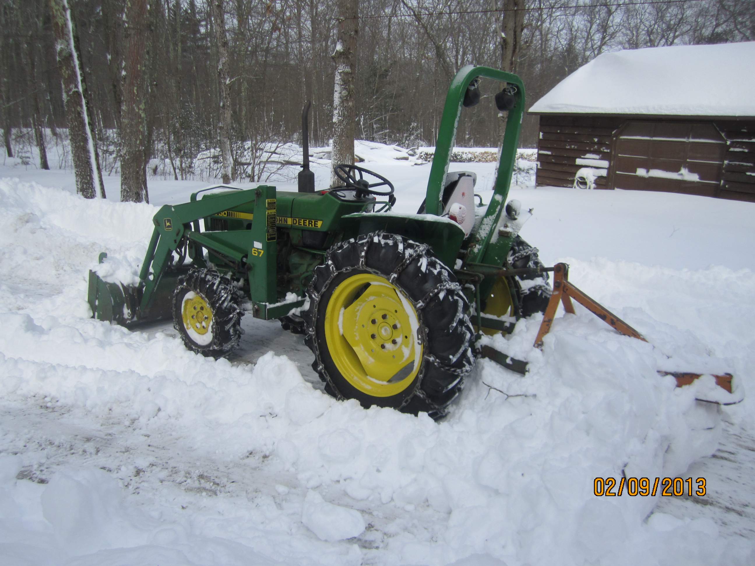

I have a 6 footer on my 3016. I backed into a "bite" of 8" of wet snow finessing near the garage door. I went 1 foot before the tractor was stopped cold. Icy underlay afforded no bite and this was with 4 link chains on ags on just the rears. You being further north may not get the wet, heavy stuff that coastal storms may generate where I live, but any moisture in snow can cause a cubic foot of the stuff to get quite heavy and will "pivot" a smaller tractor operating a rear blade. Here is a picture of 27" of dry, fluffy stuff that was handled by my previous tractor quite well. I was able to push and pull this stuff with little problem with a 6' blade and 54" bucket with a tractor coming in around 3000#'s..
