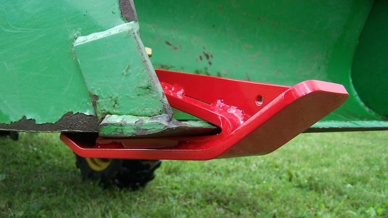

Lots of great ideas, thanks! With some "unevenness" to the gravel drive, I would think grader blade shoes would still have me shaving high points of gravel if not frozen. I guess I'm still leaning towards the steel pipe on the blade, or below the blade with welded tabs for mounting through bolt holes. I was thinking of 2" or 2.5" O.D. pipe so as not to be too small. Anyone go bigger pipe than 2.5"?

The larger the pipe the less likely to scrape gravel.
However, the larger the pipe the more snow it will pack down and ride over.

What works really well is 'edge tamers'. Very clever product!
They clamp on and are affordable.
Just like adding a pair of skis.
a pair on a 4 ft bucket or perhaps 3 on wider ones.
I DIY'd a pair for my 60" snow blower and never need to rake any gravel anymore.

Those edge tamers look nice.
Was thinking of these for the bucket, though not sure on the bolt and handle
And then there are these, though bolt on
I used these for my snowblower. Run really nice in that application.

I use three 3" Edge Tamers for my 72" loader bucket. Two at sides plus 1 in middle to prevent scalping. Have a lot of uneven areas. Works very well. R2Manufacturing has been xlnt to work with. Can also get handy extensions to carry logs, etc. with. I use them for some things in the summer as well.
