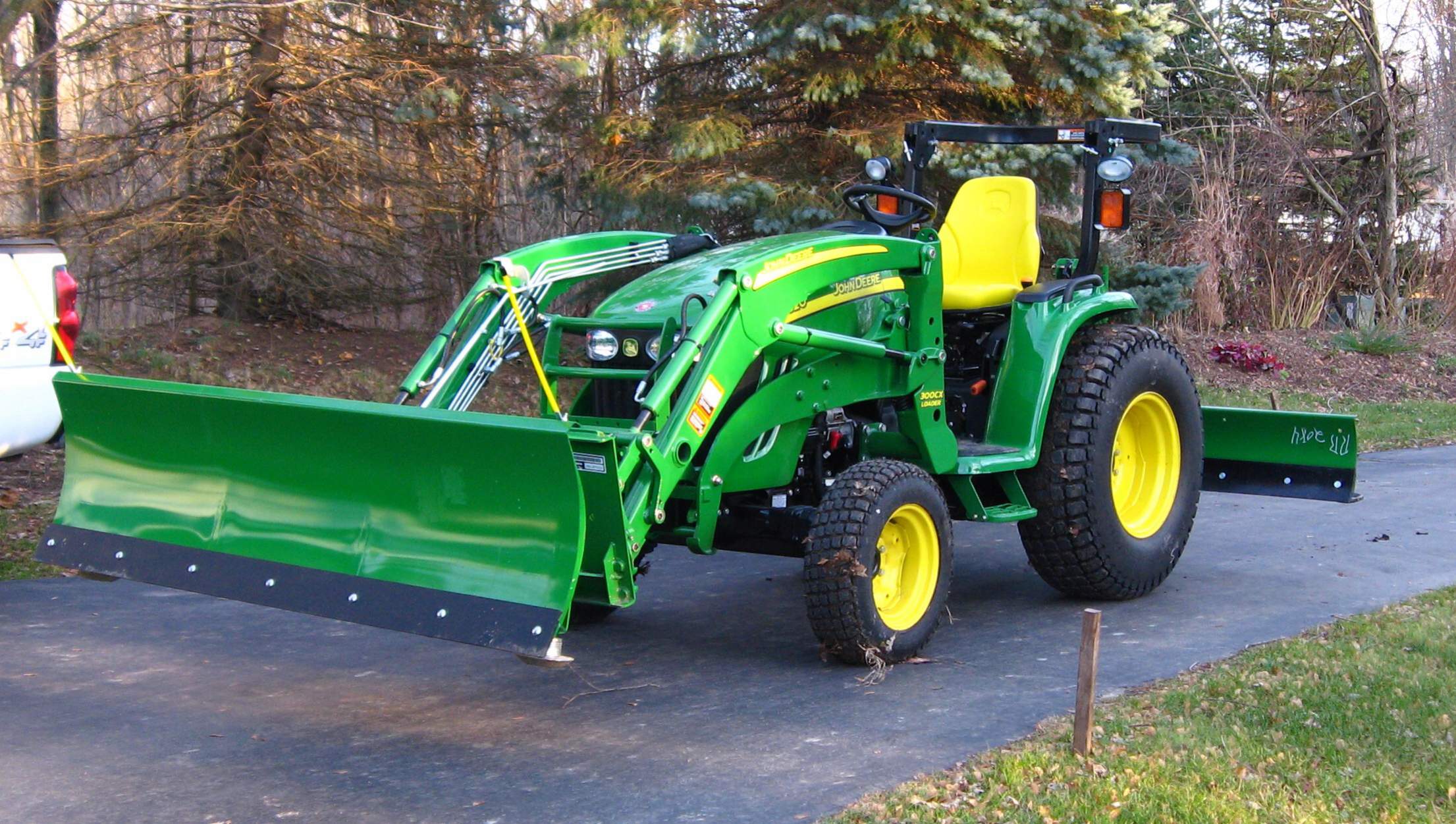

Here's my setup - after plowing snow twice, I leave the front blade straight, use it the first time down the driveway and then to clean out driveway entrances that the angled rear blade fills in. I was happily surprised to see how well the rear blade cleans the asphalt drives and road. If my front blade was hydraulically angled, I would probably use it for all plowing. However, for the many places I need to move snow straight forward, I will leave the front blade straight and the rear blade will be the main snow mover. Skid shoes on both blades. I wanted the FEL mounted blade for the easy change out to bucket & forks.
If you don't need the FEL during the winter, I have two friends that have frame mounted front blades. Very sturdy, very maneuverable, shorter overall length, and with the hydraulic angling, works just like a truck plow.
Maybe you should get a 2nd tractor and have both setups?
