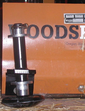

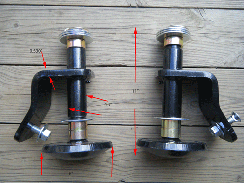

Here are a couple more !

Anyone have pics of a blade with shoes on it? I have an older Woods RB5 that will primarily be a snow blade fir use on asphalt and would be interested in seeing a shoe set up.

If your trying to keep from damaging the asphalt, you may better served lining the bottom of your blade with a piece of polyurethane or a pipe of PVC pipe. I've never done it but read of people who have. I use a power broom on my stone drive.
