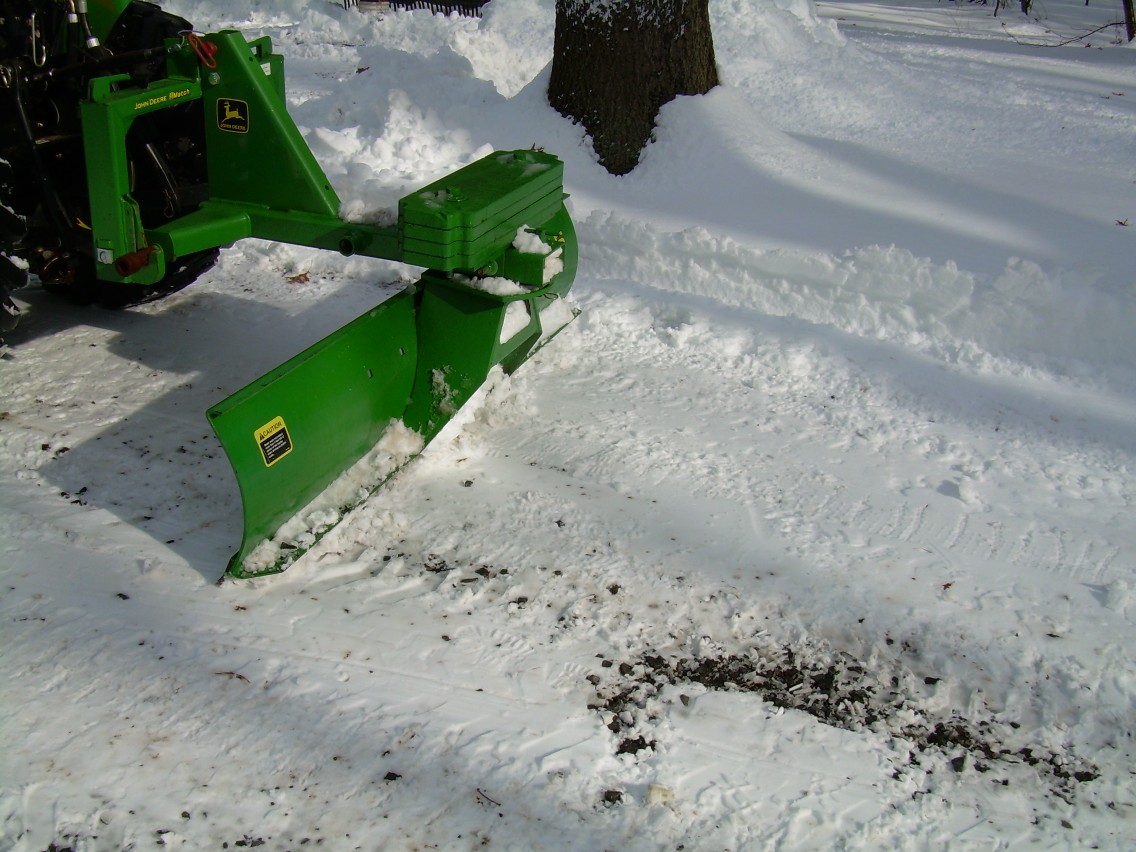

That's what I do, I added a significant amount of weight to help stop the plow from riding up over the snow when back blading.

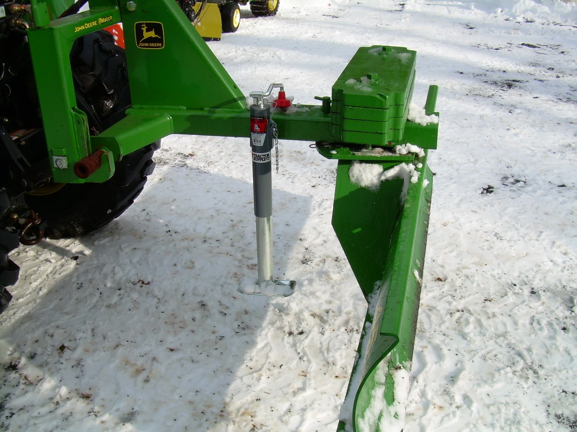

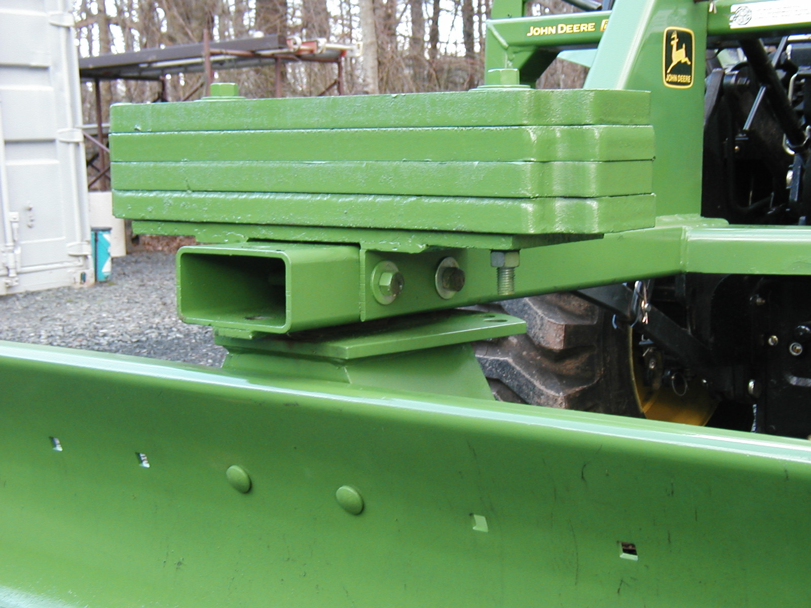

Sorry for the huge picture, here are a couple more a little smaller. this is a model 45 (72") I put the trailer jack on as a a stand.
