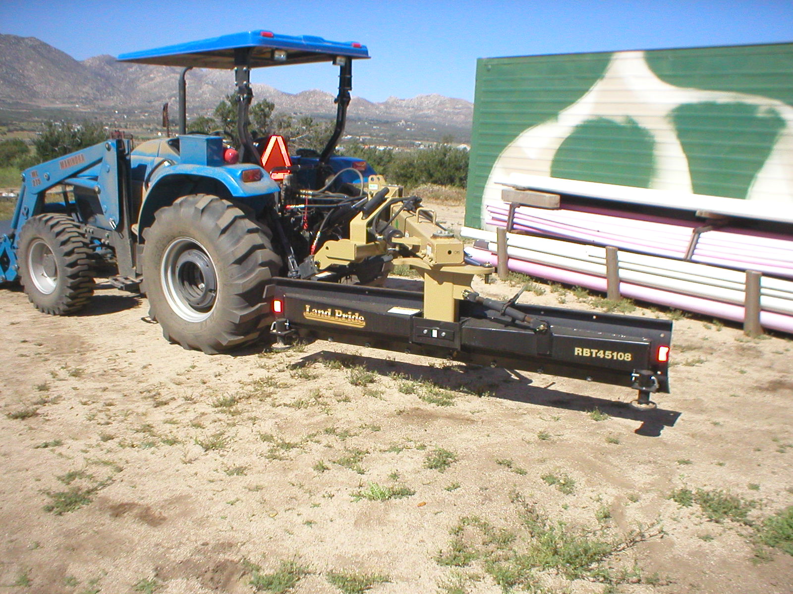

Yea, old thread but good info. Often thought of skid shoes for my rear blade also. The ones I've seen, that you can buy off the shelf, are too narrow and kind of flimsy. The first snows always result in scalping gravel off the driveway and I was hoping skid shoes might help this problem.
   / Rear blade skid shoes #15
You've just been looking at the wrong shoes I guess. Maybe the $40 ones that some blades have? Mine are 2" solid stock welded to 5/8" skid material, 6" in diameter. But they weren't $40 either, $200. Back when I bought my Land Pride blade, I had doubts about how well they would actually work. All I can say is that I recommend skid shoes all the time, that they are a HUGE help in pretty much every situation-condition. :thumbsup:

   / Rear blade skid shoes #16

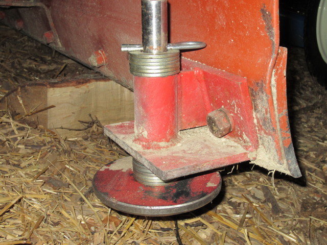

Made mine as a bolt-on.

For snow, consider making gauge wheels instead of using skid shoes. Wheels won't dig into the gravel or the grass if it isn't completely frozen.
   / Rear blade skid shoes #18
True, have to be careful until frozen. I usually let some snow pack on the gravel then the shoes will ski on top of that.
