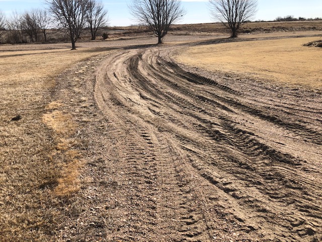

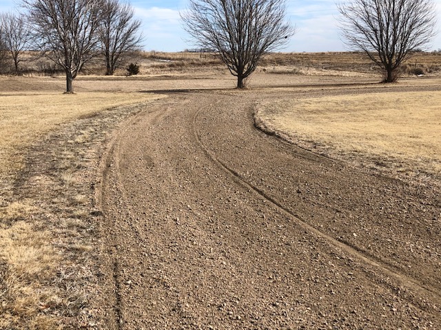

dirtworksequip said:
adb, I'll vote 100 percent for the LANDSCAPE RAKE! Not only can you keep your driveway in good condition with the rake you can also use the rake for snow removal in the Winter. You will find that the Landscape Rake will pop the stone to the surface and give your vehicles better traction in the snow. I'm going to get "flamed" on this one by all the rear blade users. If you need to do any grading of the driveway that can be done with the Front Bucket and then finish off with the Landscape Rake. Landscape rake is my choice for sure!!!
Sincerely, Dirt
Heres what a rake is capable of.
Good pics Dirt!
