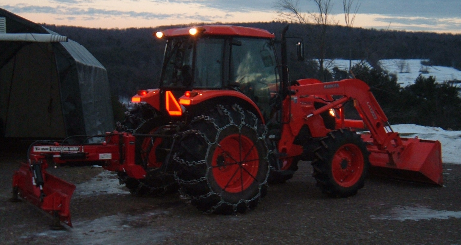

/ Rear blade? #22
I have made both a front and rear blade. Was able to use them this past week for the first time :D Our first snow fall was 8" and had no problems using both. Should it pile up to high I can put the FEL on. Will see what the rest of the winter brings. With only $150 in both think I did ok... John

Thank you for all your replies. The dealer is pretty much against the idea of using a rear blade and the front end loader to move snow. My cousin uses that setup on the farm, says that the blower wasn't the "best" solution for them. We typically get several feet of snow annually, but so far nothing to even worry about shovelling yet much less worry about plowing. My gravel drive is about 80' long and 50' wide plus some additional parking area. I also will be clearing 2 small 12 stall parking lots on my income property. If I could get jb to fabricate a front and rear blade for me for $150 I'd be down there in a heartbeat:D I wouldn't mind seeing more pics and info on that setup-looks nicely done! Especially considering the budget. Will end up making a trip to the dealer for a 60" blade after Christmas it looks like, and consider a front mounted blower next year. But $4000 is soooooo much money, maybe not next year either.
