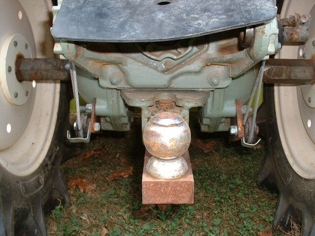

I guess I should add to the front blade comments I made with a bit more information. The front blade I mounted was free. It was given to me along with a lawn tractor (which it didn't go on by the way). It is very light, but perfect for my purposes. It is the type that has a long boom that goes under the tractor with a "U" shaped bracket for mounting to the tractor. I bolted two short pieces of rectagular channel to the loader sub-frame. The two ends of the "U" go up into the channel and I put a pin through the channel, the end of the "U" and the loader subframe.
I used two wire rope sheaves that came with the mid-mount mower and a long piece of 1/8" cable from the upper 3pt lift arms. The cable runs down to the sheaves which are mounted to the sides of the differential case - take a look at the attached photo. Then forward to two more sheaves up in front of the front axle. The cable then runs down to a piece of angle I "U" bolted to the boom just behind the angle pivot point of the blade. So the blade is lifted with the 3pt hydraulics. Basically this required almost no cost except for the cable and some scrap steel. Of course, without the sheaves from the MMM, it would have been more.
