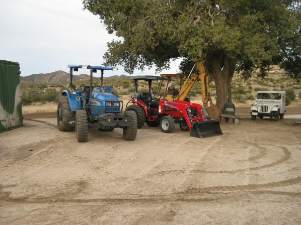

I would like to know how big a rear blade I should get . My tractor is a 3316 . Is a 7 ft blade too big ?

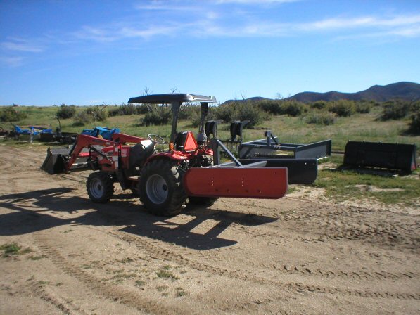

No, a 7 footer will be fine. You would be quite a bit better off though if your tires were filled. I dream of getting a Land Pride RBT3584 for my 3215 some day. :drool:

I have to disagree with that. If he has his tires ballasted, the tractor weighs over 5000lbs. A 5000lb tractor will handle a 7" blade just fine. Based on what you are saying, I can't do this (Pictures shown) and yet it does it pretty easy actually. That is a 9' blade behind a 78" wide tractor. ;)
