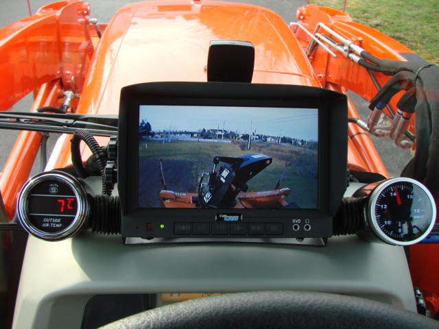

I've used my camera since 2009. It's been great for my needs and its perfect for not only using the blower but warning me if there's someone to close to me or even coming up on me fast. It's perfect for added safety but I rearly use it full time for backing up with the blower because its not a wide angled camera.
That being said mine don't have the heater and I really don't think I'd need a heated camera. If its snowing and in a storm I seldom need to clear the lens. If it was heated wouldn't the snow just melt on it then the lens be full of water preventing you to get a good view?
These cameras might not be a good choice for an open station tractor. I wouldn't need one if my tractor was an one station machine. With a cabbed machine you have blind spots due to the cab so in my case its an essential part of the machine.
