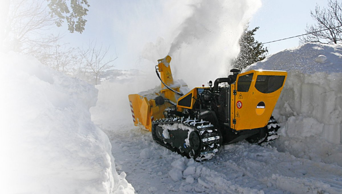

   / Rear Counter Weight for Front Mount Blower #20
I never intended to do that that; I wanted to circle each important part of the
Riest series 1000 snowthrower.
I have edited my post and removed the image with the circled and numbered parts.
I have added a front view image of the hydraulic drive single stage snow blower
offered by KOMMTEK mounted on a Mcconnel branded KOMMTEK track driven tool carrier.
I have added an image of a KOMMTEK tool carrier with spiked tracks using their
hydraulic drive single stage snow thrower clearing heavy snowpack while traveling
away from the camera on the same Mcconell branded KOMMTEK tool carrier.
Snow removal takes time, a single stage snow thrower is simply a more efficient
way to do it with an attachment that has fewer parts.
The Kommtek single stage snow throwers snow throwers flighting is slightly
different in design where the ribbon ends in curved lifting paddles.
