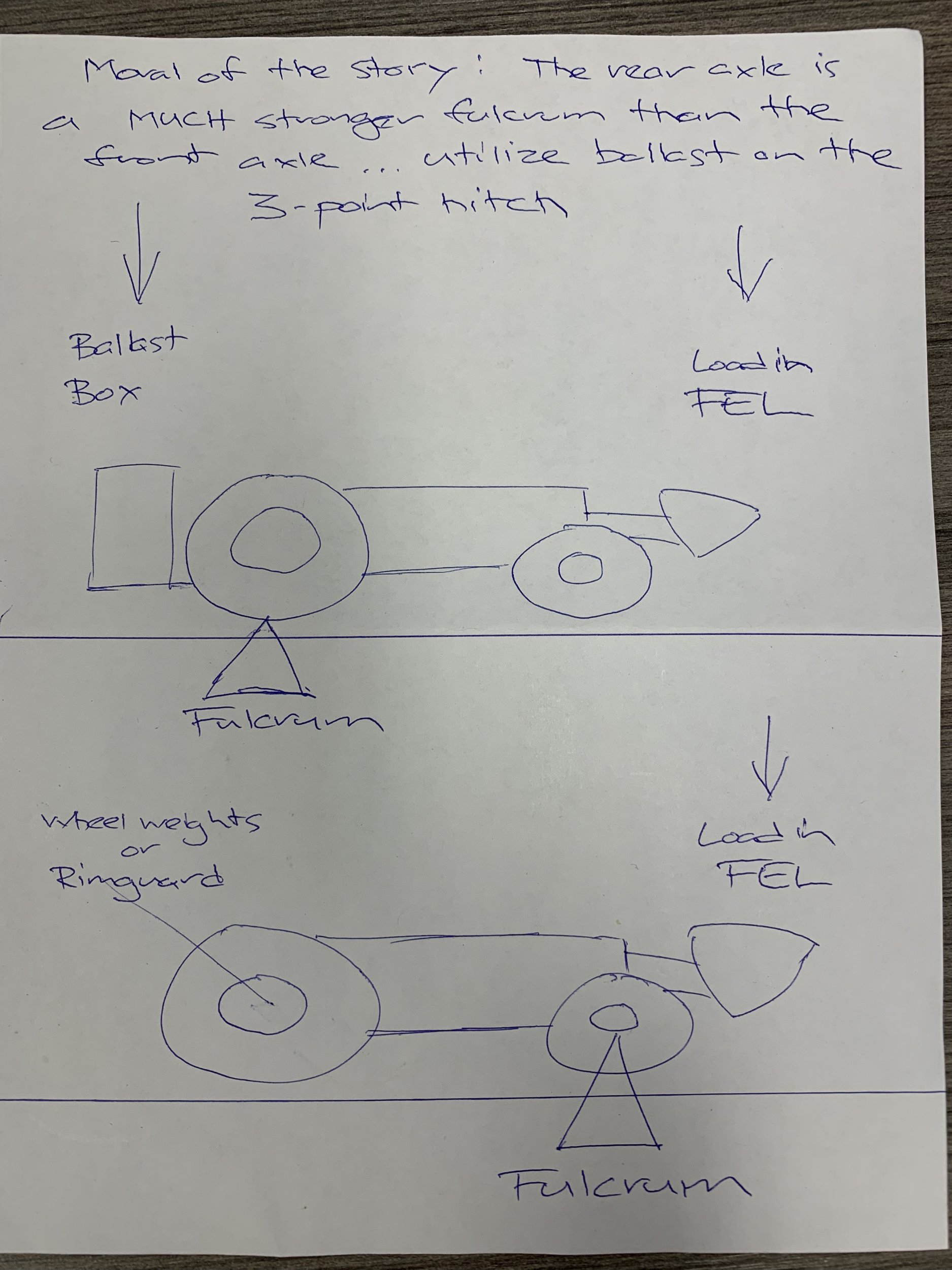

Anyone know where to find the recommended amount of rear counter weight when using a FEL? I checked the tractor & loader manual, but found nothing.

The other guys will correct me but I think somewhere around 800-900 lbs would be a good starting weight. This ballast box has a capacity of 800 lbs:
Also, keep in mind the principal below:
If your drawing is correct, please tell me why my butt gets lite and my front tires go flat when I try to lift a too heavy load with the loader. The fulcrum would be on the front axle with a loader.
hugs, Brandi
   / Rear Counter Weight #5
hugs, Brandi
The loader weight has the fulcrum at the front tires, yes. Increased load increases weight on the front axle and because of the lever effect it reduces load on the rear (making the butt lighter).
A counterweight has its fulcrum at the rear tires - unless the rear tires are in the air in which case it's at the front tires. Increased load here increases weight on the rear axle and reduces load on the front.
How much balast has to do with the maximum load the front axle - which is the weakest link in the system - can handle.
For a yourself tractor that weighs 5000 with loader but no cargo, and 1500# on the front axle and 3500# on the rear, and let's say the front axle max is 2500#.
If you put 1000# in the loader you're likely to overload the front axle because the load is levered out in front of it, which means that the center of mass of the entire tractor+load system is now farther forward - the rear is getting lighter and some of the previously rear weight is now being carried by the front axle in addition to that cargo weight.
This is why you need a counterweight. Filled tires aren't enough; they just make it harder to get the rear up, but they don't keep the front from getting overloaded because the weight isn't behind the rear axle (it's directly over it) so it can't reduce the front axle load.
By using a counterweight, which has its fulcrum at the rear tires, you move the center of mass rearwards and the rear axle ends up carrying more.
How much counterweight? The math is complex: it depends on

Just remember that the closer the ballast is to the rear axle, the less it counterweights (to unload the front axle).
Someday I'm going to build a ballast box setup that's adjustable, so the same weight can be moved farther back to lever better. The reason to make it adjustable in position is of course the farther back it is, the more it's a liability to hit things or just be in the way (like the backhoe).
hugs, Brandi
I'm not sure I can explain it much clearer. As in the Messick's video if the rear wheels are off the ground the front axle is obviously the fulcrum. Conversely, when the front wheels are off the ground (as they are when I'm carrying a boulder using my pallet forks on my 3 point hitch) then the rear axle is the fulcrum. (In this situation I use my split brakes to steer the tractor.)
If I have my backhoe on and my FEL bucket off, the front end is very light and prone to bouncing if I'm driving fast enough on bumpy ground. This indicates (by degrees) that the rear axle is the fulcrum.
What you're trying to accomplish with counterweight/ballast behind/aft of the the rear axle is to reduce the amount of weight on the front axle which is prone to failure when overloaded.
I might add there's a misconception that adding weight to the rear wheels (wheel weights or Rimguard) reduces the weight on the front axle. This is not true because that weight is not behind/aft of the rear axle. Such weight will counterweight the load in the FEL but it doesn't shift the fulcrum to the rear axle.
I hope this makes a bit more sense.

Counter weight does save the front axel but not in the way most people think. It would take immense counter weight to actually lighten the front axel by a lot. 800 pounds on a 4000 pound tractor isn’t even close to reaching that point. But what the counter weight does do is increase the traction on the rear tires. The front axel ring gears aren’t that strong and weren’t designed to do all the work. If the back tires are more planted and doing most of the work the front axel will be better off.

The OP was asking about counterweight on the rear for loads in the loader bucket. Your drawing shows the fulcrum on the rear axle. I was nicely trying to tell you your fulcrum is on the wrong axle for this discussion.
I do know a thing about weight and balance. It was required in my work as an aircraft mechanic of 42 years.
