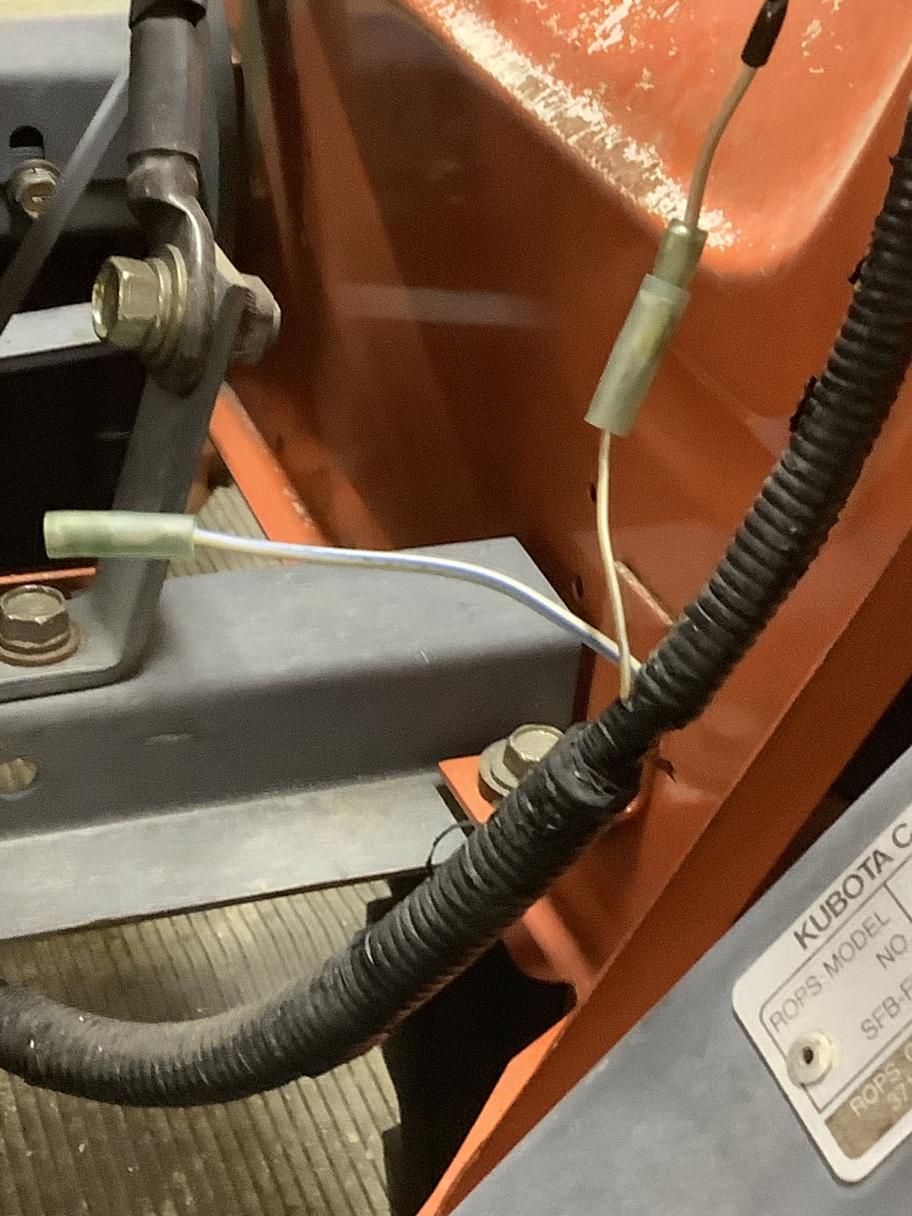

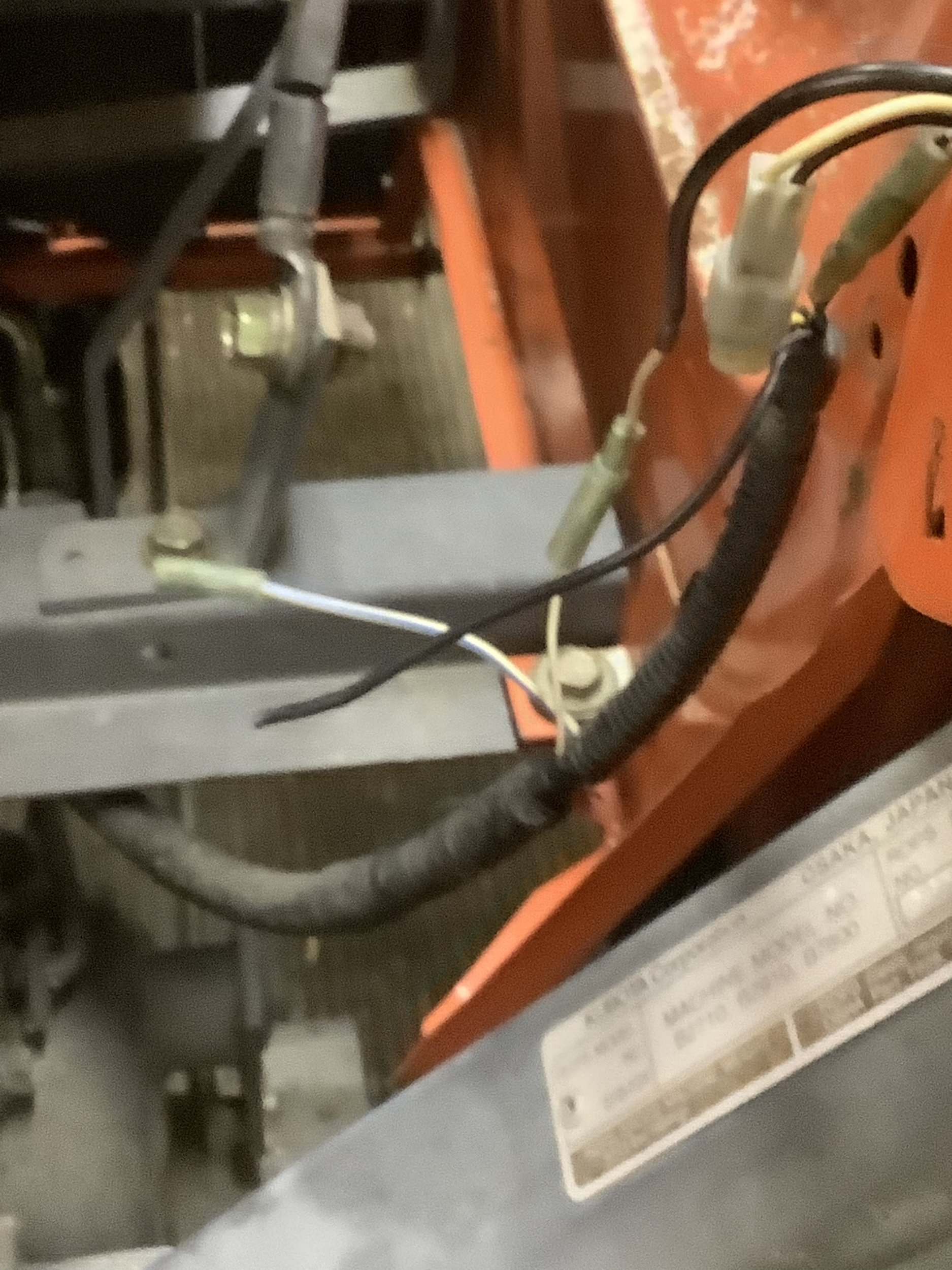

I own a 2001 B7800. I purchased this tractor about a month ago. Tonight I was working on the rear lights. I have all the rear lights working now. I have two wires I can’t figure out where they go. One is blue and white. It has power as soon as the key is on. The black wire has no power to it at all. It’s just cut. I was wondering if anyone else with a B7800 knows?

The black wire might be a ground wire? Is the other one hot ANYTIME the key is ON or does a light switch have to be on too? Not much help I'm afraid. Ignoring/not having wiring diagrams I have usually been able to find a wire somewhere around the rear fenders of every Kubota (B2150, BX2200, etc.) that is hot only when the light switch is on. Always a hunt and peck back there for me.
   / Rear Electrical
It’s not the light switch. That was the 1st thing I checked. It’s only hot when the key is on.
   / Rear Electrical #4
They do have a harness for the rear work light kit. I added it on mine. can't remember if it was the right or left side the switch was on the light but it was powered only with the key on.
   / Rear Electrical #6
I think the old style rear lights on those had the on/off switch on the light housing itself.
   / Rear Electrical #7

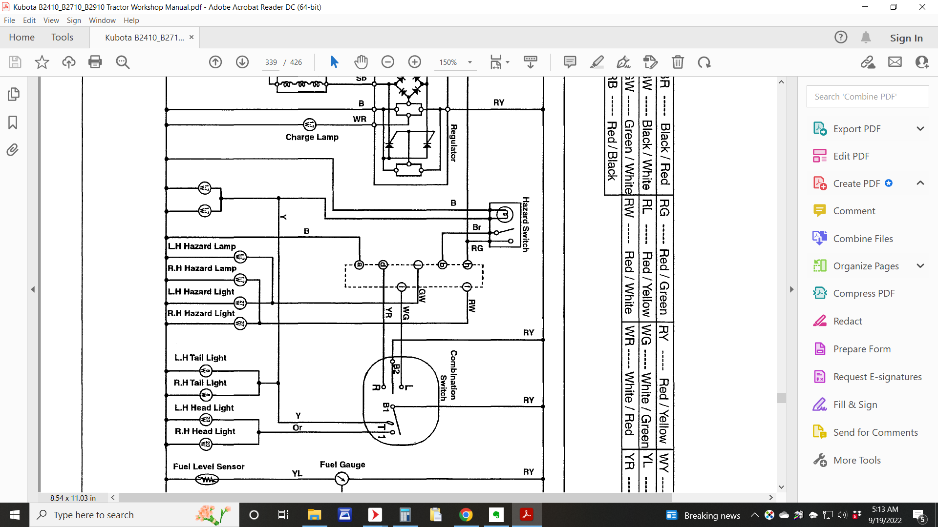

do not see a blue/white black seems to be ground
Good catch Scotty ! That would explain the wire being hot all the time the switch is on. Very logical.
   / Rear Electrical
#9
Thank you. I asked a friend who has a 98 b7800. He said he didn’t see the wire on his tractor. I’m going to add a switch and light for plowing this winter.
