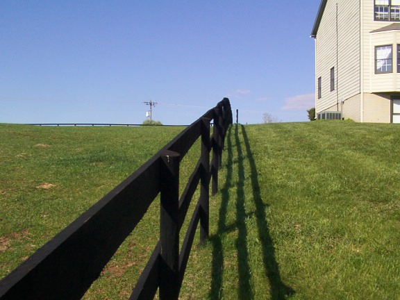

As I said above, I have a BEFCO and would recommend it. It is built like a tank. I'm on my 4th season of mowing and it does a fanstastic job.
