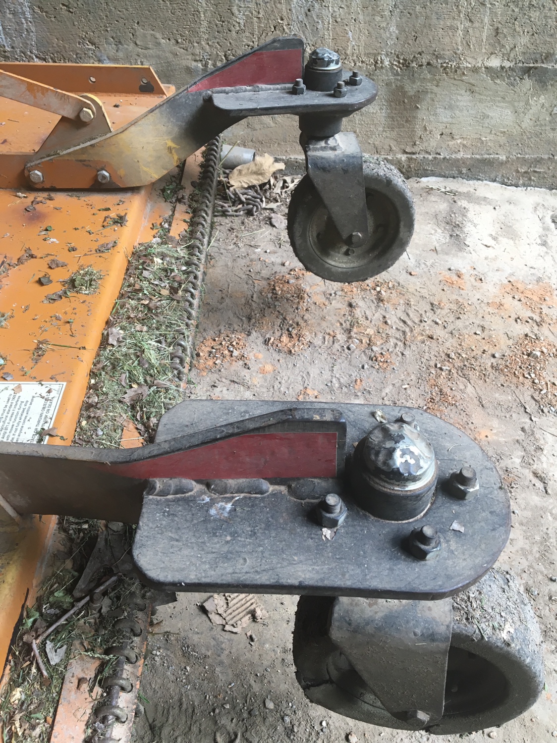

The 3pt Woods finish mower does extreme service every year for over twenty years. Leaves a nice cut on the lawn. One belt, bunches of blades and regular service. Trims close that we don’t have to weed eater much. Nice to be able to back under overhangs or ditches you couldn’t reach with a mmm.
Do like the rear discharge.
If you use your tractor for other stuff the mmm is in the way particularly in the woods.
Only problem is with two major brands of finish mowers is the wheel caster axle stems bending with the power and sharp turning radius of the B20 and B26 tractors. Loaders do not detach and rear tires are filled. After many attempts to repair finally found a permanent fix by replacing stems with trailer axles and bearings.
Less to grease, stronger and cheaper than OEM replacement parts. Trouble free for many seasons.
