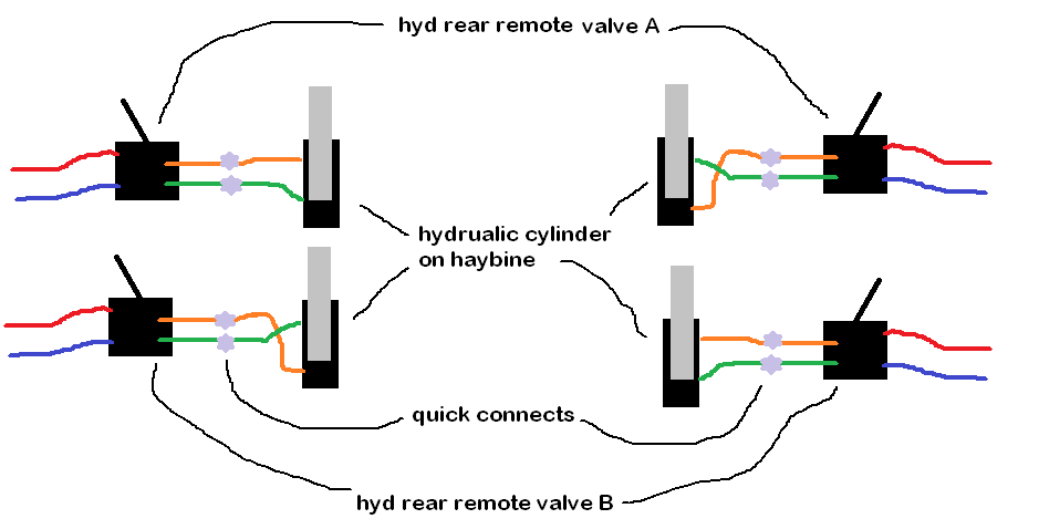

i am wondering if your quick connects are not correct for one that is slow raising / lower. and in that not correctly opening up. when you put the hoses from the haybine to the ports on back of tractor. more of a common problem with quick connects. and in that they do not properly seat. and you need to undo the rear remote hyd quick connects and then re-connect them up. when quick connects do not seat properly no flow of hyd fluid could happen in either direction or both directions and or only partial hyd fluid flows through them.
as far as the other valve suddenly dropping. you should be able to control how fast things raise / lower pending on how much you move the lever for the valve. though i am kinda wondering if a pressure relief is kicking in. and/or pressure relief is not set correctly perhaps.
NEVER TRUST HYDRAULICS!!! when holding something up!! something can and will go wrong and someone will either be injured or dead. always use something to support hydraulics when lifted up. make it a floor jack or like.
you can use either valve to control raising / lowering of haybine. BUT the hoses coming from haybine need to goto same valve for given hydraulic cylinder.
below image is just trying to show you can swap hoses around.

i am wondering if you are confusing a "single acting cylinder" vs a double acting cylinder.
single acting cylinder only has one hose connected to it. while a double acting cylinder has 2 hoses that connect to it. valves setup for double acting cylinder, might work with a single acting hydraulic cylinder.
in a double acting cylinder / valve setup. it does not matter how hoses are connected to the valve. the valve will work either way.

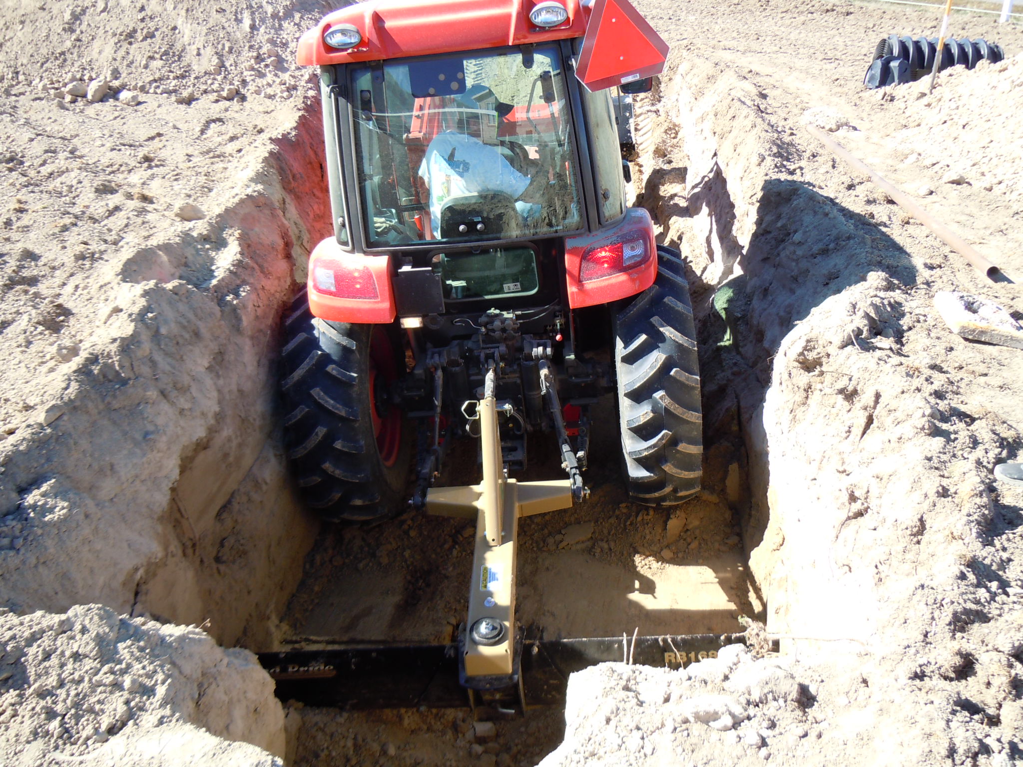

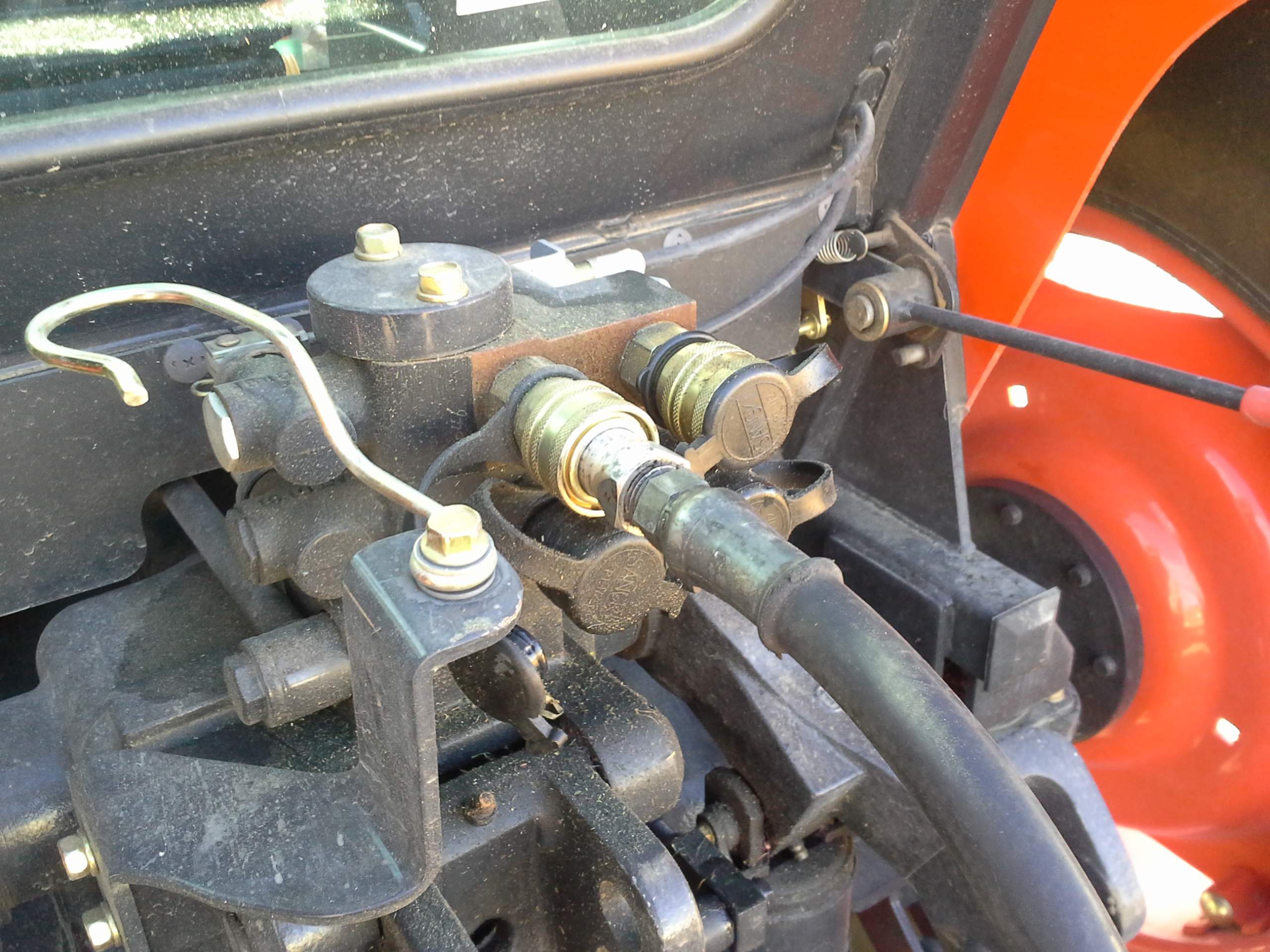

Thank you all for responding. Sorry I do not have a picture of the back of my tractor.
I do have a single acting cylinder. (one hose) I think what I need to try is hooking the line from the haybine to the dealer added hydraulic. (left side)
That is the only thing I did different. I have always been using the factory set up. (left side) and when I was working on it I had the line hooked to the add on right side.
My main question is, if there is a difference in the right verses left side on a single acting cylinder when hooking up the hose? If that makes sense.
Found a picture.

The valves just stack on top of each other, so really no way of hooking anything up wrong when dealer installed the second valve. Both valves should work the same, only difference is if you switch to the Right port over the left side port the control lever would work opposite than it did with the other valve ; where as if when hooked to right port , pushing control stick may raise and pulling it back would lower, then if you switched ports pushing would now lower and pulling would raise. If you are using a single acting cylinder ( one hose) there is only hydraulic pressure used to move the cylinder in one direction, the other direction is usually done by the weight of the equipment and gravity. On your rear remotes when you push the control lever say forward, it supplies fluid pressure to one side of that valve while it opens the other side of the valve to tank return which is open flow and the more you push the control lever the farther the valve moves opening the tank flow more an doll awing more fluid to return to the tank and also allowing more pressurized fluid IN to the cylinder on the other side. So to slowly lower the cylinder you would have to only slightly push or pull the control for that valve , depending on which side of the valve you are connected to. That being said don't forget that when using a single acting cylinder on a double acting valve, that as your pressurizing and dead heading the port with no hose hooked to it and causing the relief valve to open and fluid to bypass, anytime this happens the fluid will build heat at a high rate. Hope this helps a bit and is understandable.
   / Rear hydraulic lines
CB,
Everything you said is how I thought it worked. My guess is your NX works the same as mine. It's just that on the dealer added valves when I tried to slowly lower the haybine it just dropped. No control what so ever. The factory valves I can raise and lower more or less depending on how much I move the control lever. So do you think there could be a problem with the dealer added valve?
