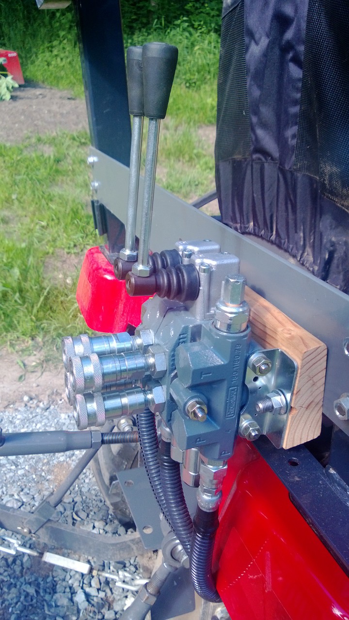

Have you considered stacked hyd valves.
3 SPOOL 20 SERIES PRINCE STACK VALVE POWER BEYOND
Just order the sections that you need and set it up the way you want.
You can order any section to suit your needs.
I hadn't really thought about it before. Due to the limited space in the operators station I was looking to use the space made for the OEM set-up but I was looking last night and it might not be too hard to fabricate something up on the right fender for a set-up like that.
Thanks!

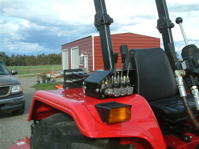

   / Rear hydraulic lines #25

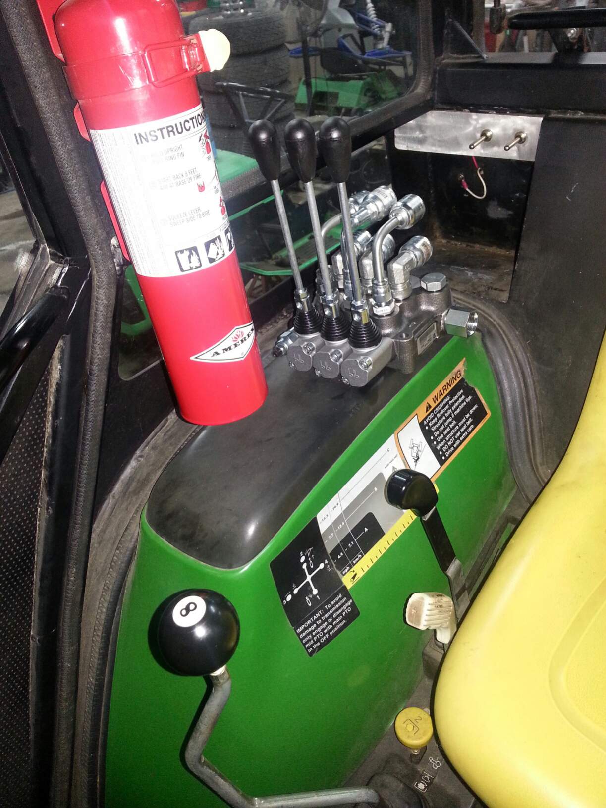

How about something like this.
   / Rear hydraulic lines #27
Those pictures are not mine, but some other TBN members.
I use them for reference and illustrations..
