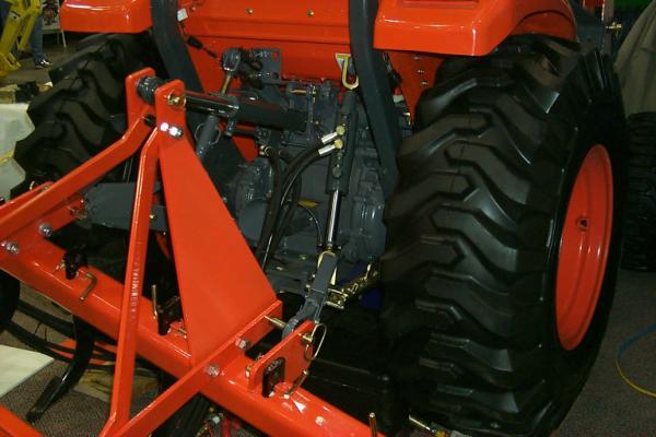

<font color="blue">Whats the TNT? </font>
Top 'N' Tilt <font color="red"> (see attachment) </font>
kiohio wrote:
<font color="blue">One set costs 276 add a second set for 375. Total for 2 sets...List price $650.
KO
(740) 753-9242
</font>
Jon Depratt wrote:
<font color="blue">The kit includes EVERYTHING you need to installed the remote valve, all the way down to the decals and rubber handle grip for the lever.
The kit does NOT include just lines, but everything that is needed.
Jon DePratt
</font>
Don <font color="blue"> </font> <font color="blue"> </font>
   / Rear hydraulics CK25/30HST
To do the TNT as shown in the attachment does one need just one set of hydraulics?
What would two accomplish?

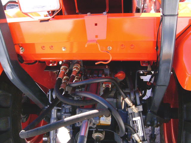

   / Rear hydraulics CK25/30HST #9
You need 1 set of remotes for each cylinder.
If you have 1 set of remotes you can run a hydraulic top link, but you will need a 2nd set of remotes to operate the tilt cylinder.
Attached is the remotes on my DK 35

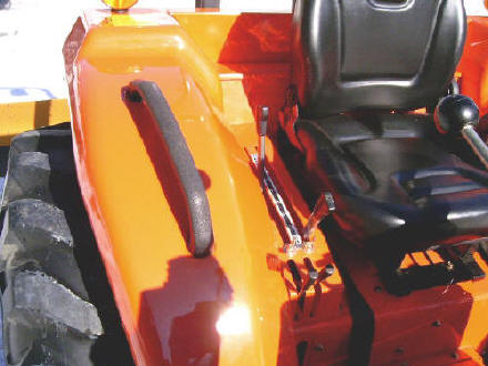

   / Rear hydraulics CK25/30HST #10
The controls for the remotes and TNT cylinders are the small levers just in front of the position/draft control levers
