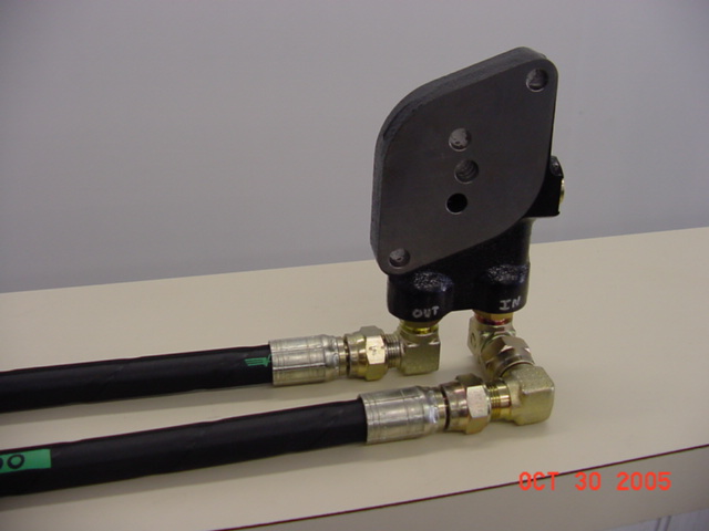

Kenny, in the pic. on post # 8 I see a plugged port on the bottom of the plate, when I look down at valve assembly on my tractor it looks like the other port is on the top of the plate, so you have one hose coming back from the top and the other one from the bottom. right?
   / Rear hydraulics for 2005 4110 #16
]Oscer, you have the "plate", and it is very close to same if not even identical to the setup on Jim's 2520. Sorry but I don't have time right now to stare and compare in JDP.

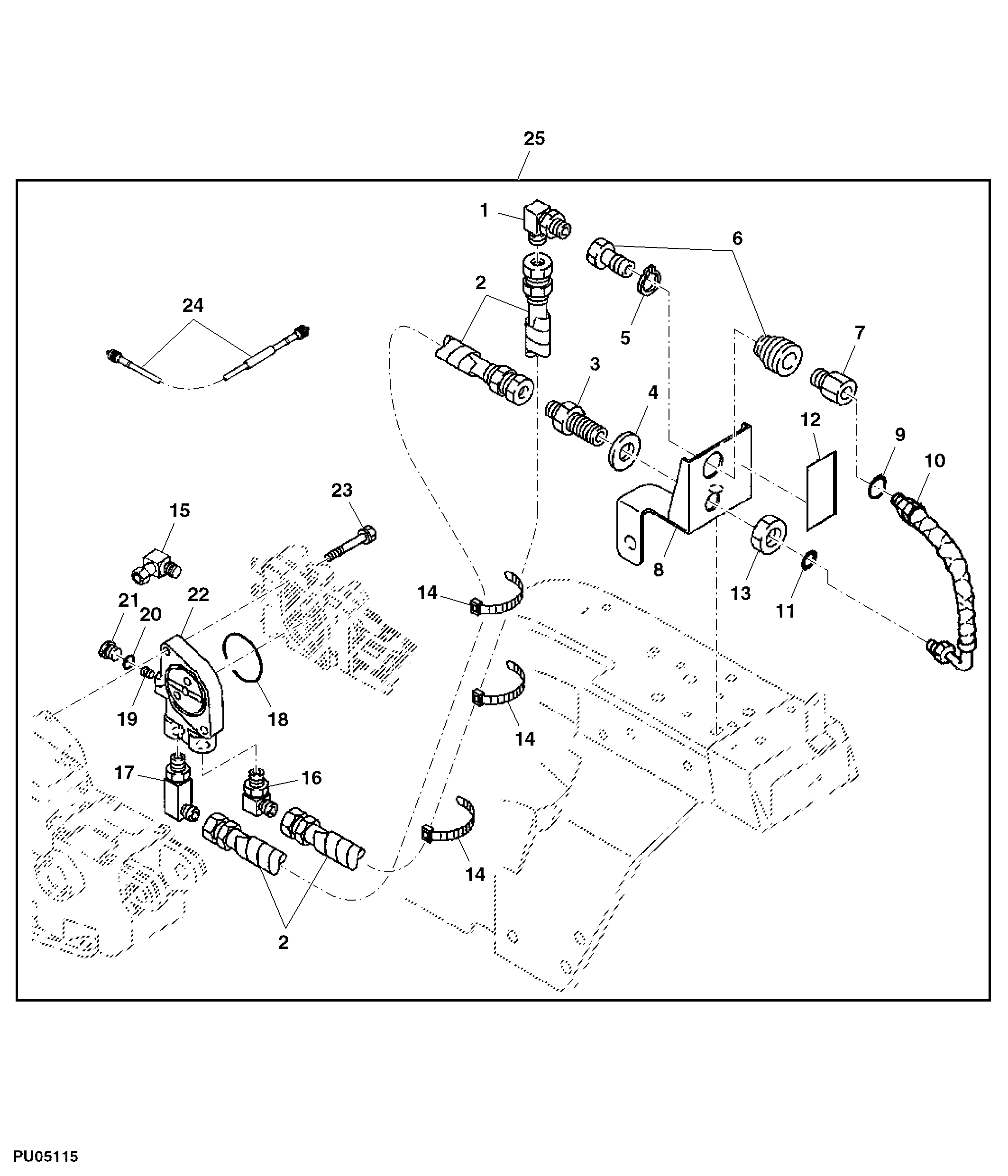

Here is the setup on mine, I though this picture was included in the post I made years ago:
   / Rear hydraulics for 2005 4110 #17
Maybe the JD parts pic will help you visualize it better. I did this more almost 15 years ago with my 4100. You have the block, plug it, add hoses, valve, connectors and your good to go. Always remember to keep continuous flow back to the block.
