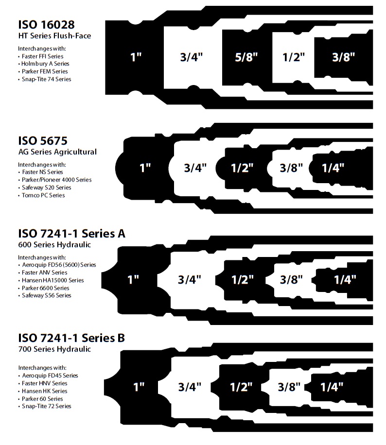

These are the pictures from the current male cables I have.
From the sizing chat. That was posted. I think they are the ISO 7241-1A and you were correct it is 1/2.
The link I posted earlier can you tell if it is the 7241-1A
View attachment 535390View attachment 535391
NPTF Refers to Nation Pipe Thread Female, which is the type of thread in the body of the coupler. The easiest way to cross reference the coupler size and style is by taking the numbers off the sleeve of the female coupler, and either post them on this forum or google them. The numbers (and letters) will identify the coupler size and type, and will help you cross reference them to other manufacturers.
NPTF does not refer to the coupler type or size. That is just a hydraulic thread designation.
The pictures in your post are not ISO 7241-1B couplers. 1B couplers have a long lead section on the male tip.
   / Rear Hydraulics Quick Connector #12
Have a look at this picture. Its a great profile view of the 4 most common hydro quick connects that we would use, and their designations and compatibility.
The first one in the picture, the HT series flush face, is nice, as its easier to keep the faces clean and keep debris out of your system when hooking up. These are commonly found on skid steers, and are very durable. But they can be notoriously difficult to hook up, compared to other types.
For my tractor and equipment, I'm quite partial to the series A, as the poppet is more durable and leaks less over time than the agricultural style ball. That flat end on the poppet takes most of the beating over time, which saves the sealing surface. You can also get a series A version that has a small button on the poppet that allows for the relieve of residual pressure that makes hookups much easier. see part# VP8010-4P-DC, or click on this link Pioneer 1/2 in. Connect Under Pressure Tip, 1/2 in. NPTF at Tractor Supply Co.
