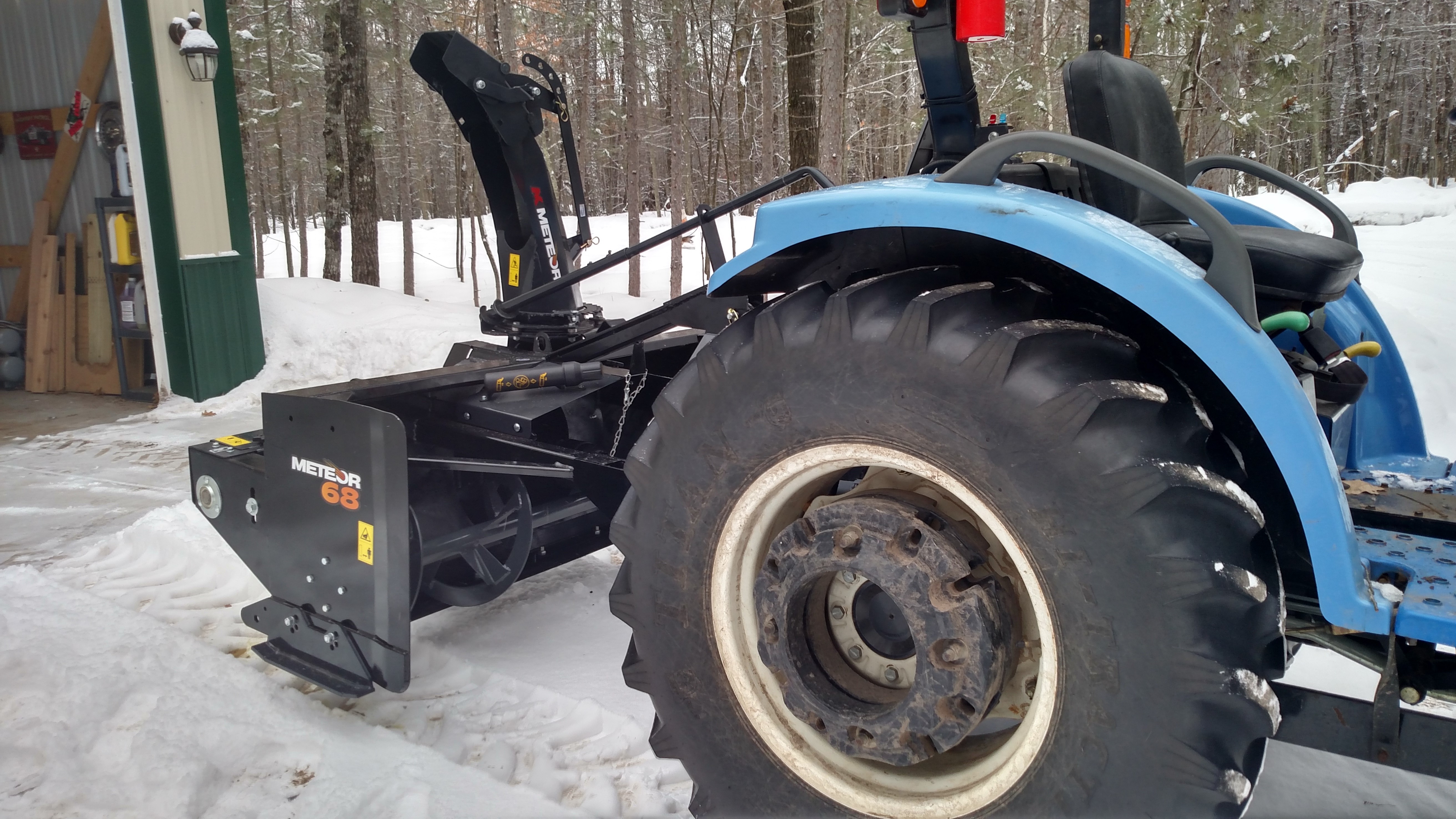

Ready for snow!

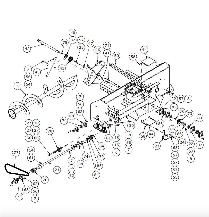

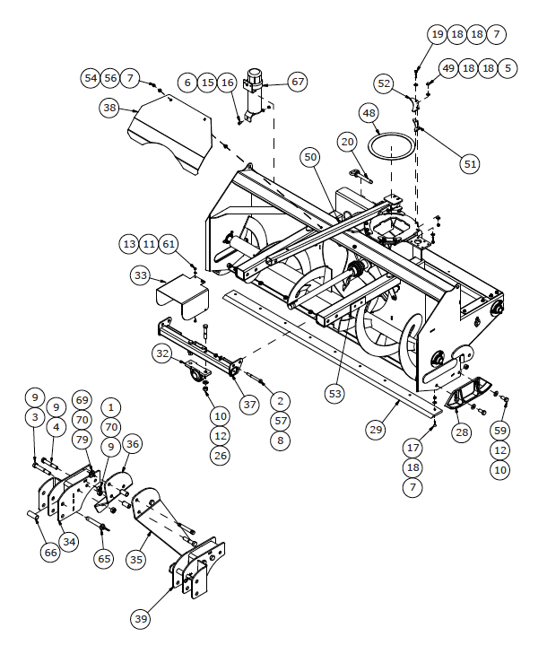

I sure hope that is not the root cause because if it is, then the replacement parts are not going to fix the problem. I thought it must be that someone didn't tighten the locking collars properly and now I am hoping that was the cause, not shaft misalignment. How would I go about checking that.
Here are some parts diagrams showing the 2 driveline shafts that are linked with a roller chain coupling. I have never seen one before and Googled it. According to the site I found, these couplings are capable of operating with a fair amount of misalignment.
View attachment 637284View attachment 637285
Have you looked at why shaft #41 is not staying where it should be in the gear box? Are there locking collars on those bearings too?
