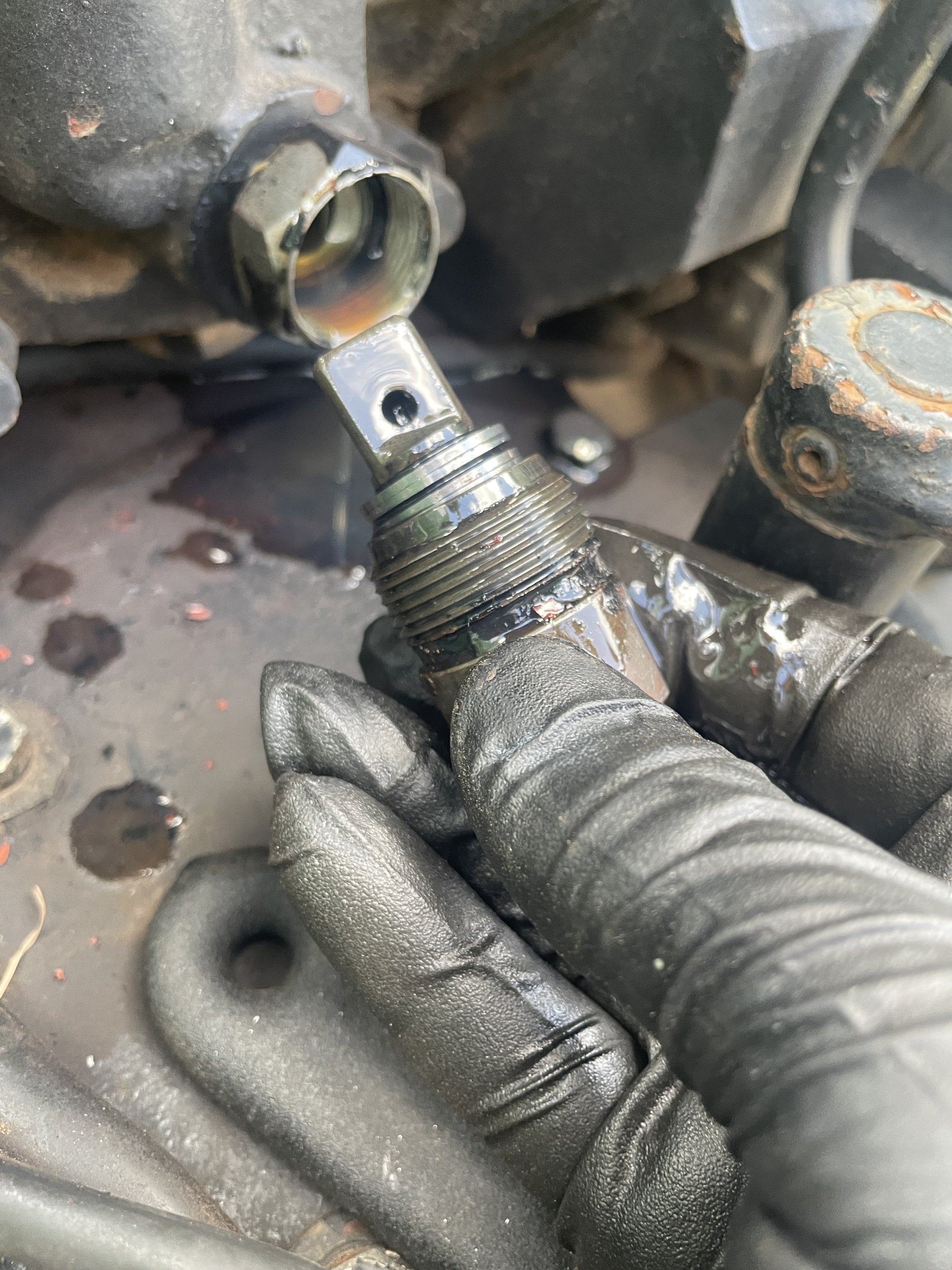

I took the rake off to clean the hydraulic rods and now it won't lower at all. I took out that valve under the seat and have no clue what i'm looking at, it's a hollowed out plug packed with stainless washers and a little triangular key. Adjusting it open and closed doesn't seem to have any affect on getting it to lower.

It sounds like to me the valve controlling flow for the lift (one under the seat) is not opening up fully restricting the lowering. The pressure of the hyd oil from the pump is much more than the weight of your rake to push the arms down.
It has been said already but be careful with arms up with implement taking the knob totally out of that valve. Load could drop real fast with damage to it, tractor and YOU.

i just realized that valve probably is closed, when i pulled the fitting off the triangular key part was just sitting in the cup loose. So tightening it and loosening it isn't doing anything. probably have to try and tack it in place and see if that does the trick
