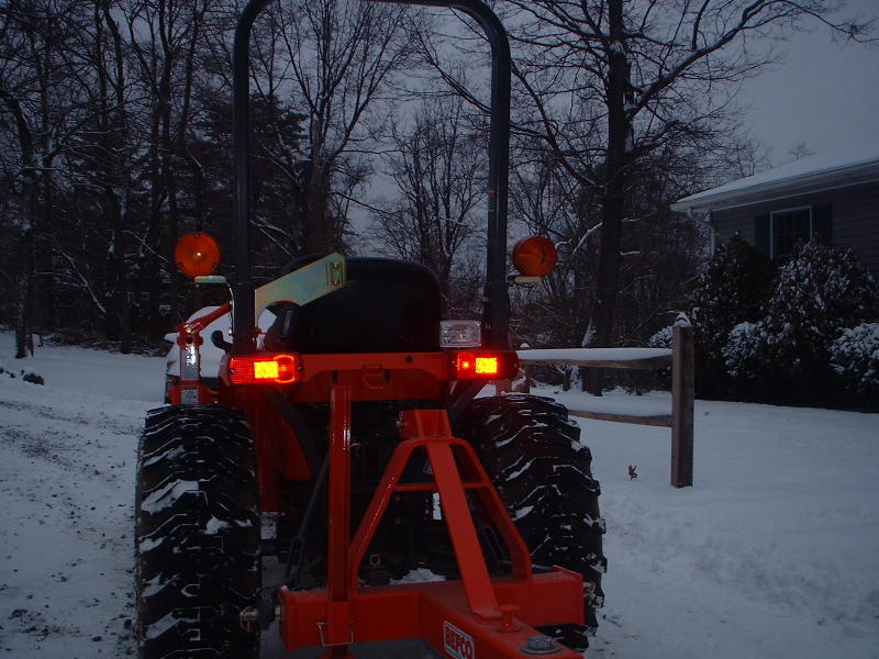

Heres a good pic of when I finally got time to mount my work lights on the back of my monster tractor and it works fantastic. My only complaint is its 2 times brighter than my headlights, If only I could put these bulbs in the front lights/w3tcompact/icons/hmm.gif/w3tcompact/icons/smile.gif

Sure looks cold out there, Jim./w3tcompact/icons/wink.gif
   / Rear Light #3
That Befco blade looks just like the one on my TC 29D. So far it seems like a well-made blade to me.

Glueguy, I was thinking of doing that but I am a rather large person and I was afraid that the only thing I would see is this large melon head shadow cast in front of me with a hat on/w3tcompact/icons/laugh.gif I was happy with how much light it cast out but that is when I realized just how dim the front lights are. I was hoping someone would notice the stay fender I installed that is for the B2410/w3tcompact/icons/smile.gif
